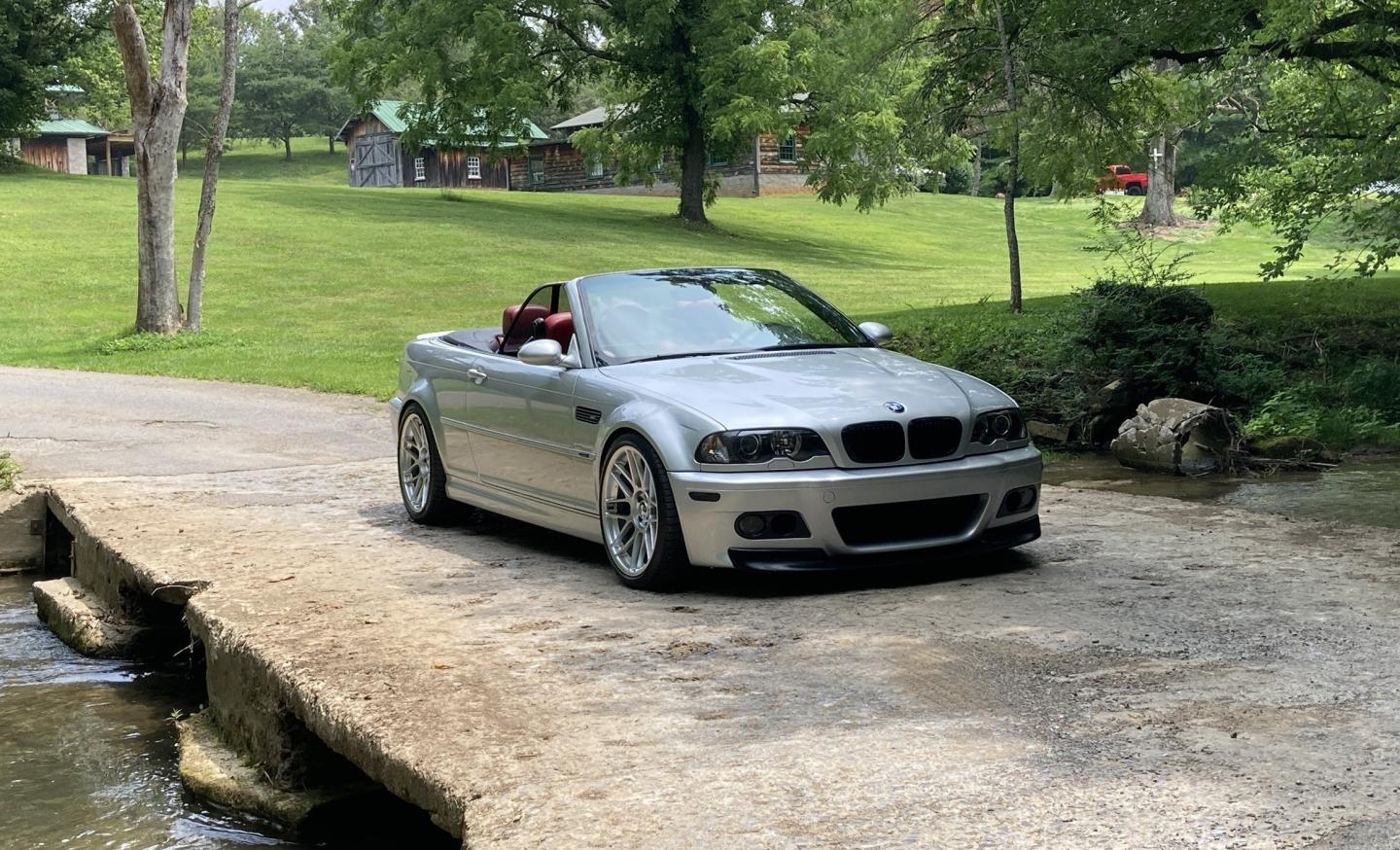

            The biggest variables that haven't been mentioned yet are your ride height and camber settings. If are running a more aggressive front negative camber setting you will need the lower offset front. I tend to lean on the aggressive side fitment-wise (which always gets a negative reaction on this forum) but I would suggest the 9.5 +22 and 10.5 +22 option, if your set on running staggered sized and have -3* or more negative camber up front. Also assuming you have rolled fenders and trimmed rear fenders.
            This is a 9.5 +20 10.5 +20 set up with 275/35 square, -3.4* front and -2.5* rear camber:
              I like 19x9et28 and 19x10et25
              2 degrees up front and 1.8 degrees in the rear.

                Oh man…that looks fantastic! 👍👍
                  Thank you. I use a 10.5 square set with 265s for the track but this is my street set up.

                  What a wonderful vert. Perfect cruiser.​
