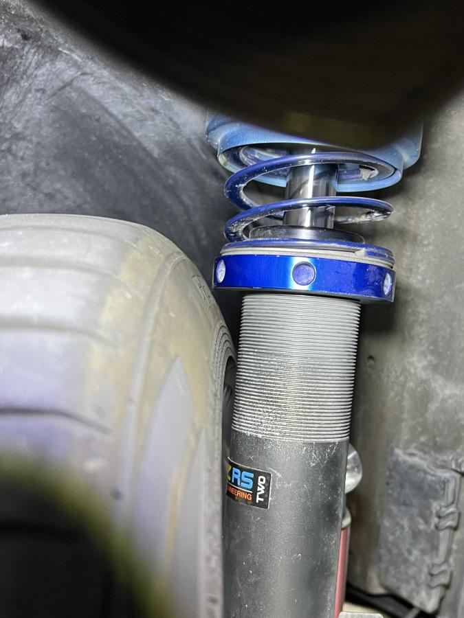

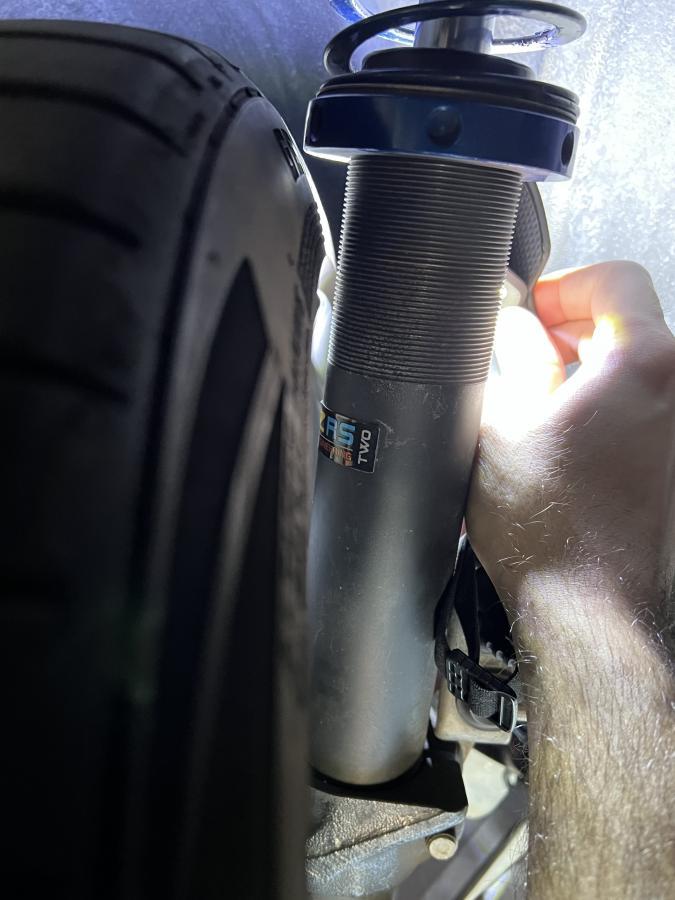

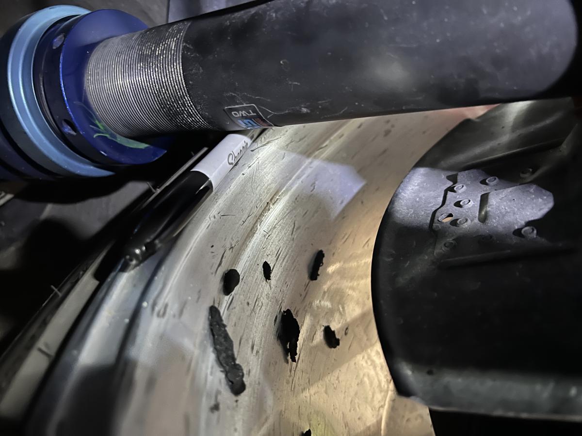

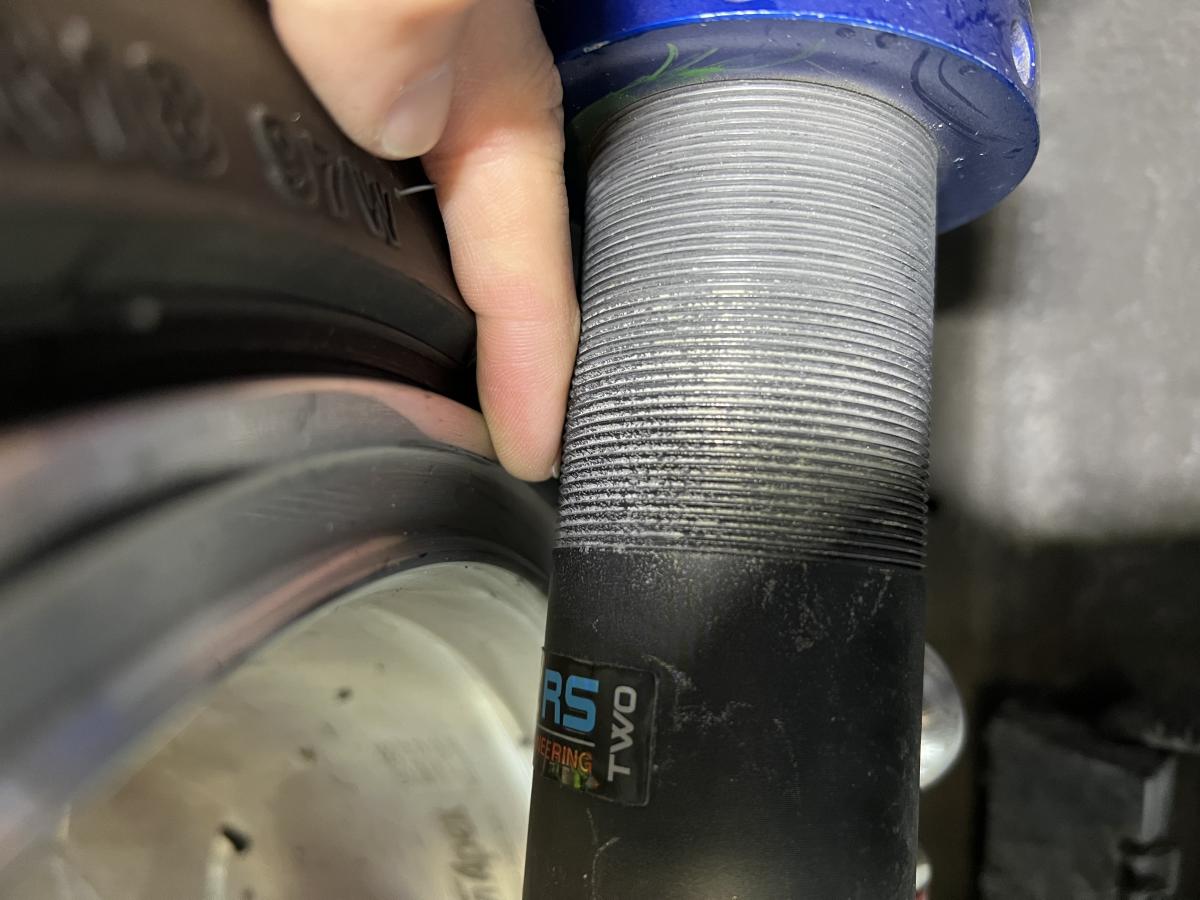

                      While looking into my HPDE car’s possible bumpsteer under hard braking issue, I’ve also been suspecting my wide track wheel setup’s high positive scrub radius is contributing to me fighting the wheel and instability under hard braking. Inspired by Gearhead55, BBBRTuning here and Japanese tuners’ time attack M3s over in Japan I’ve been running a 18x10.5 et22 on 265/35 square setup since last January. I like the setup and have no fitment or rubbing issues on track, can even turn full lock with minimal fender liner rub. The front strut spring perches are maxed out on the threaded damper body, and even still the tire isn't fully under them (6” spring), there’s just a fingers width of clearance (~10mm) between the tire sidewall to the spring perch and the wheel inner lip to the damper strut body (thankfully the 265 stretched has the sidewall curving away).
                      So I’m considering going back down to a 10” wide wheel and wanted to see whats the highest offset i could run to bring the scrub radius down as much as possible. I test fit the 513M rear wheel from the daily (18x10 et40) with a 5mm spacer for effective et35 and was just barely able to clear the maxed out spring perch and strut body, but with a 275/35 tire. Figured I’d share my findings here as while i was researching this topic across 3 different threads on here this one had the most recent post.
                      Im really leaning towards picking up a new set of 18x10 ET33 wheels (both BimmerWorld and Apex have models in this spec), sticking with 265/35 tires, and running 12mm rear spacer for effective ET21. Just I have too many wheels as it is and wanted to see if it’s worth going down this route before spending money on new wheels and another set of 200tw tires.
                      Pics: current 10.5 et22 265/35 setup (sharpie sitting in the gap)
