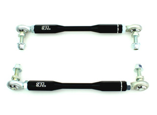

                          I realize not everyone is looking for "the best", but from what I've seen nobody makes a higher quality end link for our cars than SPL
                              Learn more about our adjustable rear sway bar endlinks for E46 M3/E85/E86 Z4
                              If these Turners don't work I'll certainly give these a go. I also read a positive review on these from another source.
