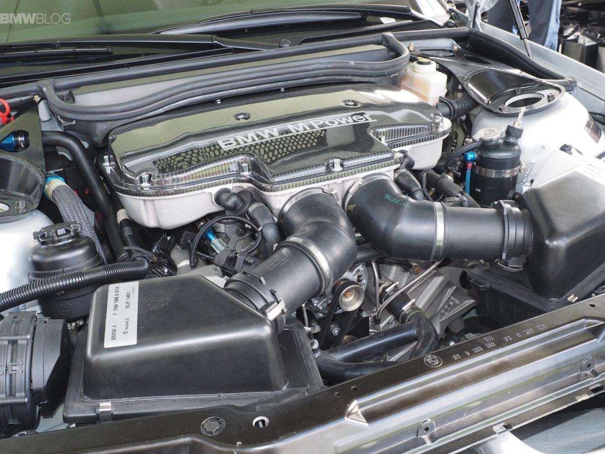

        See pic below on the GTR reinforcements I was talking about. I need to get on the computer and spend some time with cad 😅
        Both items combined should give some really good structure.

                    How do those plates attach to the firewall?
                        I don't know exactly, I haven't seen this up close. I'll have to visit bmw classic sometime and ask if they will pop the hood on the car they have there.
                        My thinking is to use L brackets to attach these reinforcements to the chassis, as there is no premade mounting items there. The brackets could be welded on or with chassis adhesive (like the CF roof). They have to be somewhat easily removable, otherwise no more access to the ECU compartment.
                        I would also combine this with a strut brace to avoid stacking plates above the struts.
                        In my case I also have to design the passenger side one so it goes around my battery poles.

                          It's definitely bolted to some structure or bosses welded to the firewall
