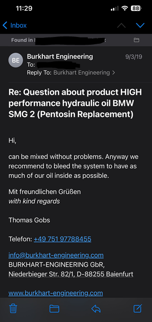

                    Got it directly from their website.
                    “The new oil is not mixable with the Pentosin. When changing oil there should remain max. 5% of residual oil. Proper bleeding of hyraulic system is necessary.”

                        I think the idea is to get as much CHF11s out as possible for the new fluid to work better, it does not damage anything or prevent the system from operating. See below:

                          Thank you! That’s helpful. I actually emailed them this morning with the same question… was doubtful I would get a reply. So appreciate that.
