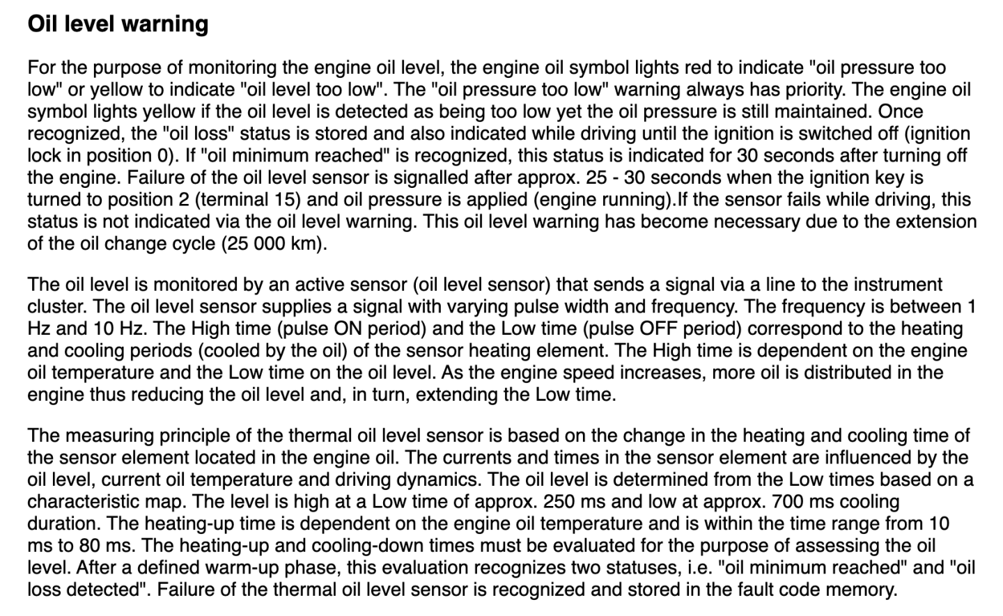

              The oil level sensor is what's called TÖNS (Thermischer ÖlNiveauSensor >> thermal oil level sensor)
              It's essentially a heating element. That measures time in a heating cycle and a cool down cycle. Afaik heat cycle is for temp and cooling cycle is for level. It communicates values to the instrument cluster via PWM. The instrument cluster has the corresponding functions coded in to extrapolate the oil temp and level readings.

                  Straight from TIS:
Name:	Screenshot 2024-09-10 at 1.40.48 PM.png
