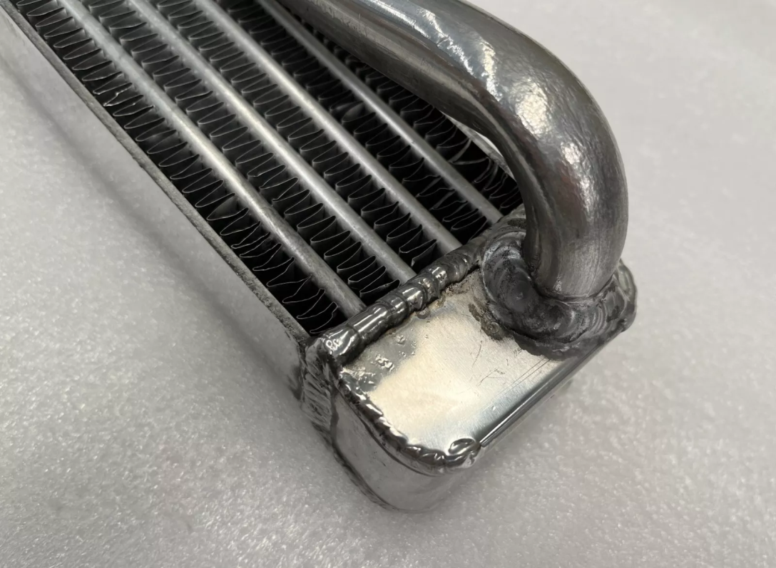

          On a side note there’s a company (Winner Racing) basically making a replacement in size and layout to OE. Runs about $261 shipped, but from China. Although even the CSF says made in China too.
            Anyone have experience with the “Winner Racing” oil cooler?
              Interesting. Looking at the pics, I'd question the weld quality. An ugly weld can be a good weld but some don't look like they're fully penetrated which is a functional issue. That would be a much bigger concern than appearance. The weld on the end tank looks like it is just sitting on top, no fusion. Not an expert either so keep that in mind.

                              Yeah I did notice the welds and piping not looking too pretty. But if it leads to a functional issue not so good. Figured since they’re part of a radiator company they still knew what they’re doing. But made in China might mean..not so much.
