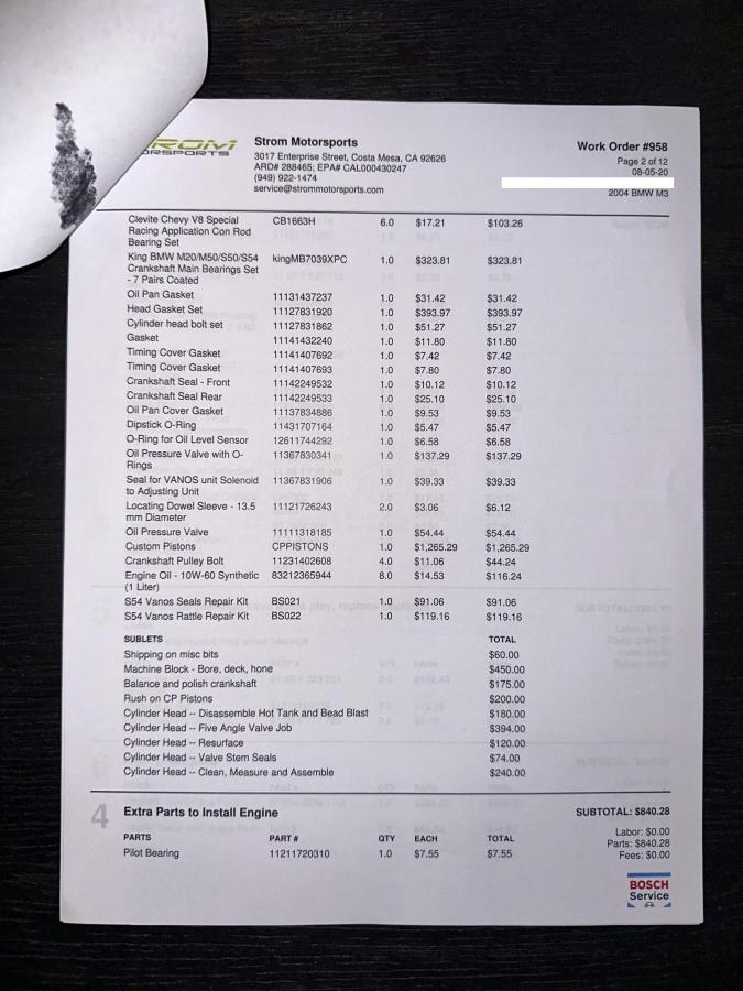

            Backstory: Initially this engine was built by an ex-PTG employee (parts listed in original post). A friend of the owner of the car was driving it on track, and overheated the engine.
            When the engine was overheated, Strom disassembled the engine, and rebuilt it (invoice attached). The car runs extremely, extremely cool — PWR radiator, AC condenser removed, Motorsports thermostat. It takes me maybe 20-30 minutes before oil temp gets to 180-200 degrees. Coolant tempt stays at first dot no matter what.
            Just not sure why there is piston ring blow by…or what I need to do with this engine next. I’m worried the block is toast, since it has been bored out once (when it was stroked to 3.4L)…then the bores were cleaned again when Strom rebuilt the engine.

                Correct—Strom rebuilt the engine roughly ~4,000 miles ago (all track mileage) in 2020. The engine was only rebuilt because it was overheated. I believe they have a two year warranty, so unlikely they are willing to work with me. It’s far from a true race engine. Has 12:1 compression, was built to be reliable above all else. Not to set any NA horsepower records, or rev to the moon. The collector I purchased this E46 from has 3 others with 3.4Ls (near identical builds) and has put a combined 100,000 track miles on them without catastrophic failure.
                And sounds good re: dyno. I typically go to EAS for dynojet, but if Jery is closer, happy to take my business to him. Would 100% want to have the tune inspected before hand to ensure no major red flags.
                And correct, sold to get back into an E46–but maybe bit off more than I can chew! I have poor luck with E46s. I had to replace the engine in my last one too.

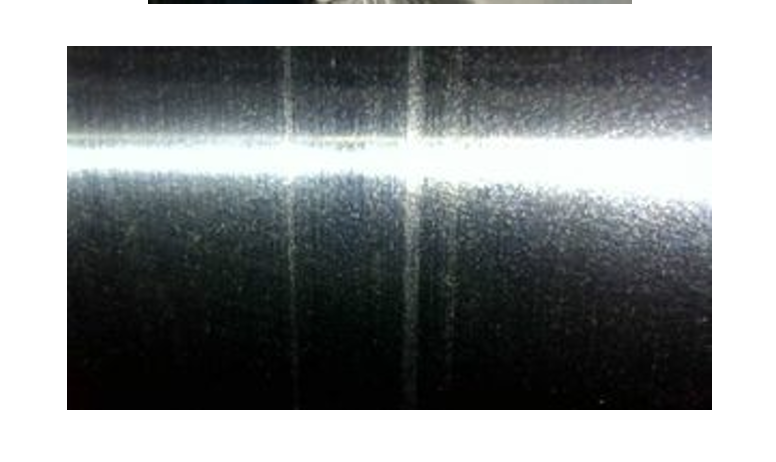

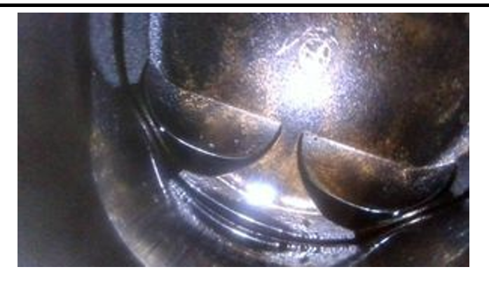

                      I would just keep driving it without fear (assuming bearings are ok )
                        Do another leak down test - could be an error, unless confirmed by another test.
                          Alex,
                          The amount of oil he has on top the piston
                          indicates something is going on.
                          I know how you think, hope dies at last..but it
                          won't hurt to confirm the first test.
                          Regards,
                          Anri
                          https://www.instagram.com/euroclassicmotors/.
                          www.euroclassicmotors.com
                            Originally posted by Anri View Post
                            Alex,
                            Regards,
                            Anri
                            I know. But LD is rather easy to do so why not? I'm not a huge specialist on the issue, but could the oil be there due to a different issue?
