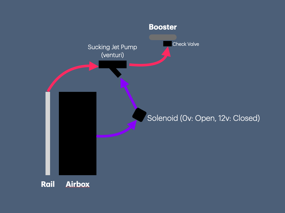

      I made this diagram that hopefully clears up how this system works. The Solenoid just controls if there is airflow to power the venturi/sucking jet pump. Normally the booster is harvesting engine vacuum and storing it by way of the check valve and check valve seal.

        I made this diagram that hopefully clears up how this system works. The Solenoid just controls if there is airflow to power the venturi/sucking jet pump. Normally the booster is harvesting engine vacuum and storing it by way of the check valve and check valve seal.​
        Unsolicited nit: I would swap the direction of the red arrows so that they're consistent with the direction of fluid flow.
          #34
          not gonna lie. i did waffle back and forth as to how to draw those red arrows.

              I think the booster is NOT harvesting engine vacuum unless the hall effect switch is opened. Again, unplug the solenoid and the brakes will start to progressively self-apply as the engine runs. When you shut the engine off the brakes release. Unless the booster adds boost when not under vacuum.
                  Ok I did an experiment to verify.
                  There is no obstruction in the Y-pipe/venturi/sucking-jet-pump whether the solenoid is open or closed. So there is an unobstructed path between the air rail and booster check valve at all times.
                  What I did was pulled the check valve from the booster. With engine at idle you can feel vacuum whether that solenoid is open or closed.

                      Again, unplug the solenoid and the brakes will start to progressively self-apply as the engine runs. .
                      For a normal working brake system this should never can happen because the pressure on both sides of the boost diaphragm are the same, giving ZERO force on the diaphragm and the master cylinder push-rod. The only way this could happen is there is a small air leak on the valve located on the driver side of the booster, leading to this side has high pressure and the front side of the diaphragm has high vac, leading to the diaphragm being pushed forward on the master.
                                Unplug the solenoid with engine running creates higher vac inside the booster as compared to plugged in. But the higher vac applied to both sides of the diaphragm and so zero net forward force on the master rod. Your booster has a small leak at the pedal push rod/booster seal to cause the self lock-up at higher vac.
