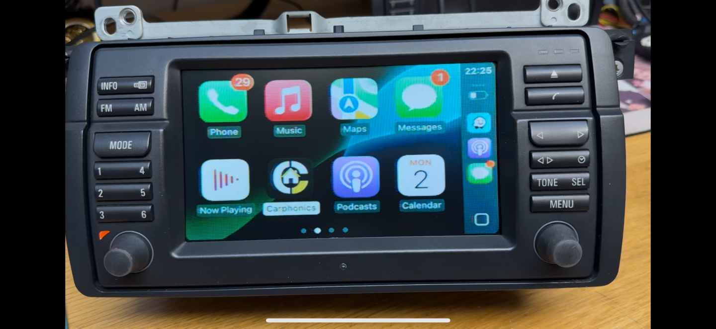

    I thought I’d post my Apple Carplay setup. I wanted to retain as much stock functionality while also gaining the more modern phone integration that Carplay offers.
    I used Raspberry Pi 4 (64-bit) running REACT Carplay. My car was already equipped with a factory BMW navigation system and TV module (DIY back-up camera). TV module allowed for easy RCA into to the nav screen and a switching feature to force the screen to display video input from RCA (Carplay).
    This is by no means the most affordable way to do this. ATOT offers aftermarket Carplay head-units for cheap. My install allowed me to retain all factory equipment and have it reversible and upgradable. I had to extensively modify the factory screen, but original functionality is retained.​

    Finished Product IMG_2950 shows carplay in action. Screen display isn't the prettiest, but it works wirelessly.

    You can adjust the contrast and brightness via the television option in AV channel. Might help.
    There is also adjustable settings behind the circuit board where the screen sits. But be careful with this , because you can lose yourself adjusting it for hours, and it must ve done with the light sensor connected, or else it automatically dims.
    The light sensor should also be working, if it’s not, then the chip for it has gone faulty.
    Good job of managing to fit the touchscreen. It’s not an easy job! Touchscreen panels will add extra glare. There is a gap/air between the original screen and the touchscreen. Even if it’s sitting directly on top of it.
    Is there no option to adjust the resolution with the PI? You should be able to adjust it, like in the photo.
