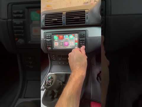

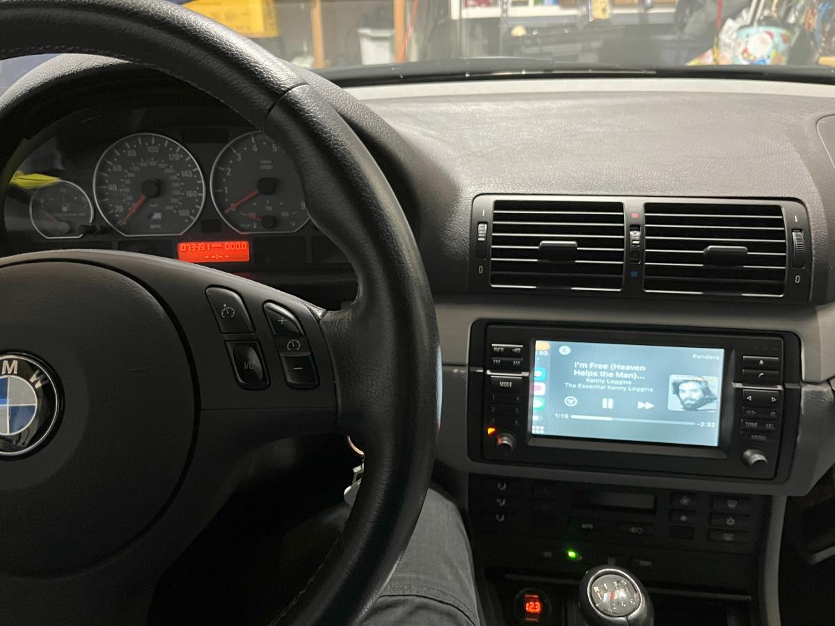

    Finished Product IMG_2950 shows carplay in action. Screen display isn't the prettiest, but it works wirelessly.

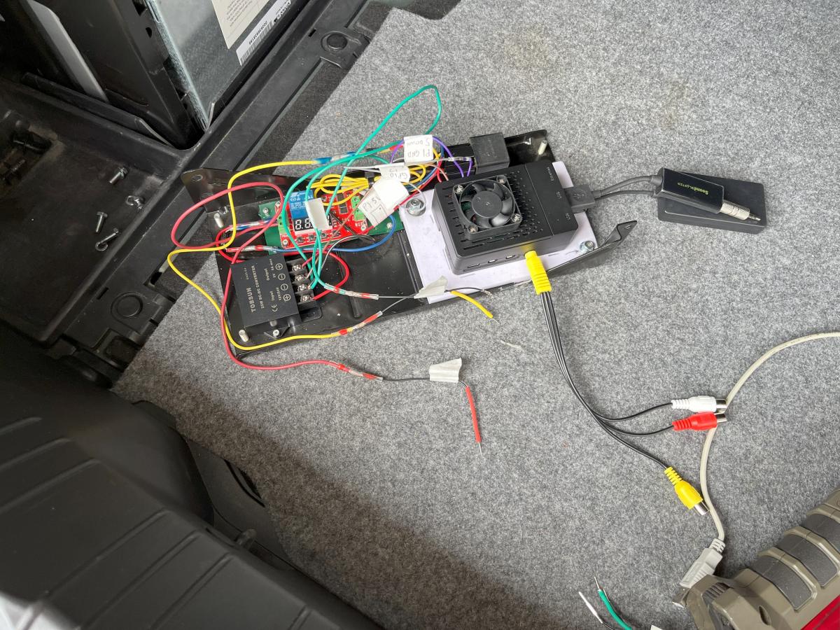

    Raspi on Bracket IMG_4175 shows Raspberry Pi 4 mounted to factory bluetooth bracket. Also pictured are the 5V power supply and graceful shut down hardware.

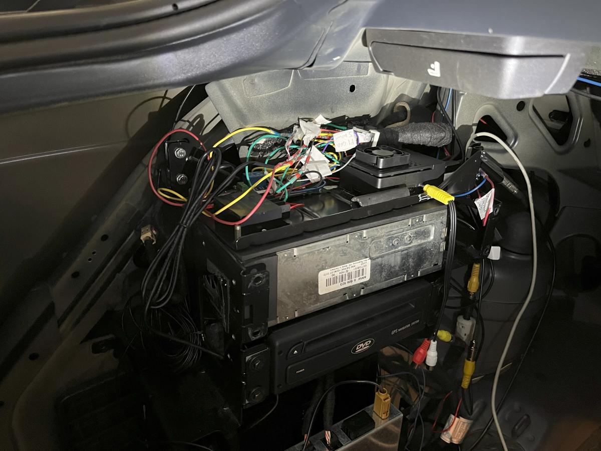

    Raspi installed IMG_4170 shows the whole Raspberry Pi unit installed in the car above the "server rack" of radio stuff in the trunk.

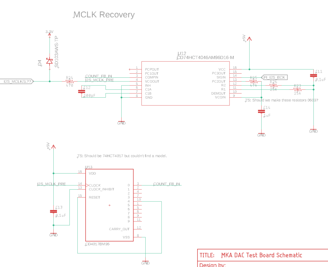

                    I'm currently stuck working out quality audio output -- the Pi has an I2S digital audio output but the master clock is not exposed, making it difficult to generate S/PDIF (for DSP cars). I have a part in mind that could do the job, but it's now been discontinued -- the Cirrus Logic WM8804. The other option is to generate a master clock using a PLL, but that's a pain.
                    Hi Ted, I think TI SRC4392 or another similar ASRC (but not SRC4192) can take I2S without an input side MCLK and give you a clean output on the output clock domain side. Probably isn't easier than a PLL though.
                      Thanks for the suggestion! I've considered using the SRC4192 on the BlueBus in a different capacity, but that price tag is so off-putting!
                      The other fellow working on this with me designed an MCLK recovery circuit earlier this week:

                        its like you guys are talkin' dirty to me. t3ddftw please put me first in line to test the carplay module out when you have it in testing.
                          Thanks!
                          -Ted
                          This sounds like a great project. What software was used for the schematic?
