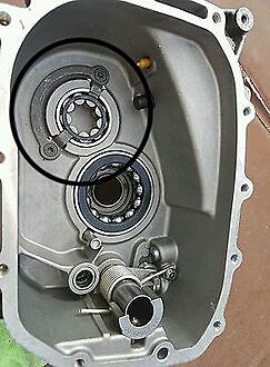

  • pawelgawel
    replied
    anyone have an idea where I can get one of the bearings within the housing? Ill post a photo with the one missing. I purchased the converted housing without it, I suspect I can reuse my current one in my car once its out, but in case I'd like to make sure there is another option.. its held on a retainer from what I see..
    Click image for larger version  Name:	E46-M3-Smg-Manual-Conversion-Bellhousing-Gearbox.jpg Views:	0 Size:	28.2 KB ID:	72372
