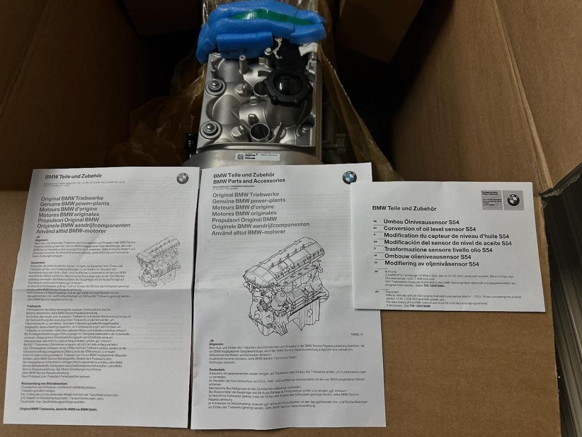

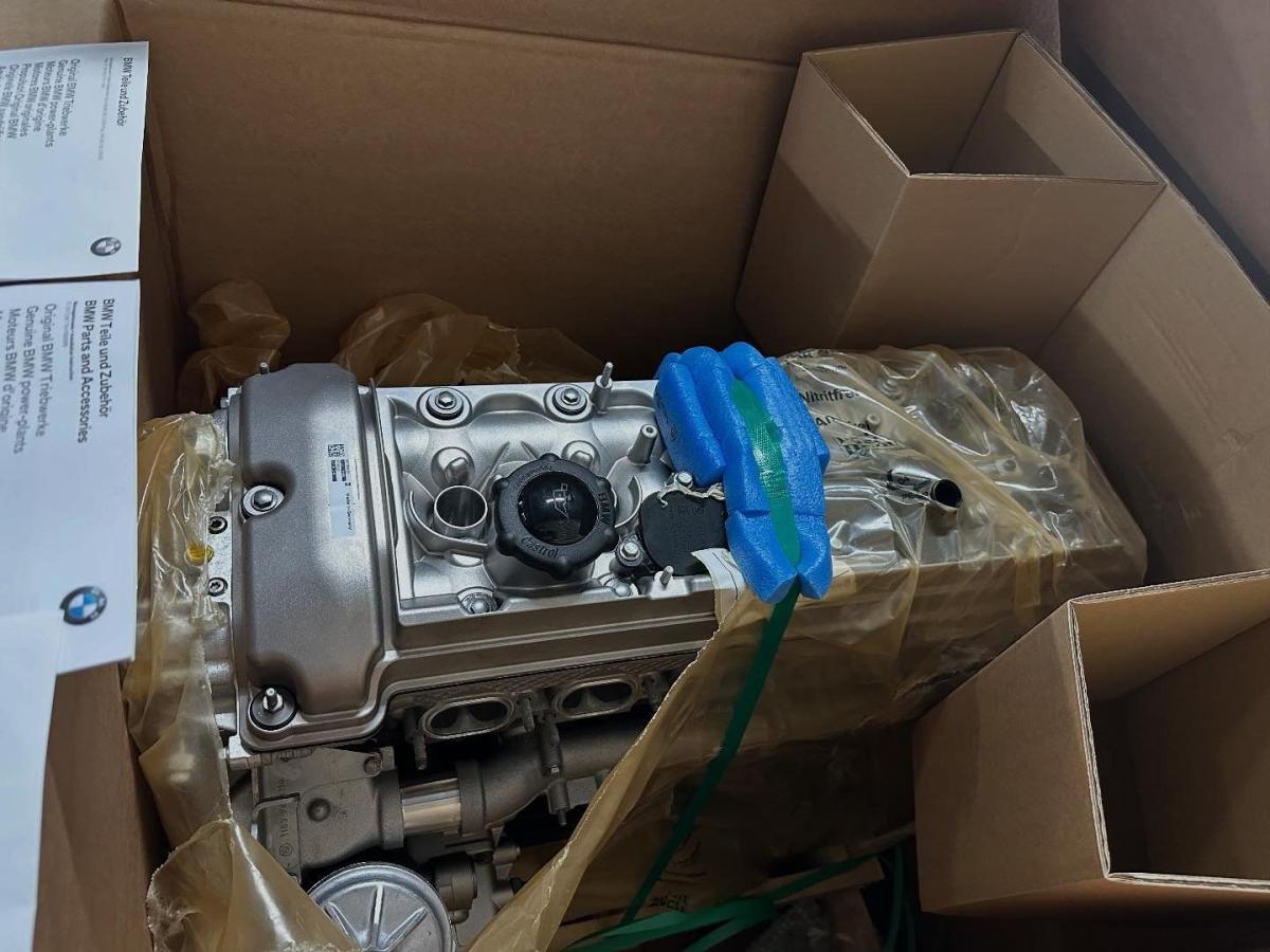

                      Could be a new head then?
                      Only someone who has ordered one would know as they can look at the date stamp.
                      Edit: Maybe it can be spotted in the images below lol

                        Its been 13+ yrs since I personally installed a new one, lol
                        I wouldn't be surprised if they use a reman head on occasion though.
