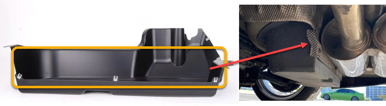

Thanks. My set is quite new, has been on the car 2 years, and has only been installed once from new, and I've adjusted the screws once. No sign of any damage or fatigue. But there's enough of a leak to have left black soot on the heatshield nearest the connection (on the passenger side), and of course all over where the screws are.Originally posted by CrisSilberGrau View Post

I haven't tried any anti-seize or sealant yet, and certainly will, but I'm asking ahead to people who seem to have tried it and failed if they've found any other way to fix it.
Honestly pretty surprised with this for such an expensive piece.
And again I ask -- does this size of leak affect performance/drivability in any meaningful way, or is chasing this more of a "it just bothers me and I want it to be right" kind of path? Googling says that generally any leaks before the cats (which it is since my sec1 is catted) is sure to affect performance, but also they also describe any exhaust leak as being very obviously audible, which this one isn't. I was actually hanging out under the car with the engine running the other day chasing a leak and did not notice at all that there was an exhaust leak. Maybe it only happens at certain points in motion when this joint is stressed?
