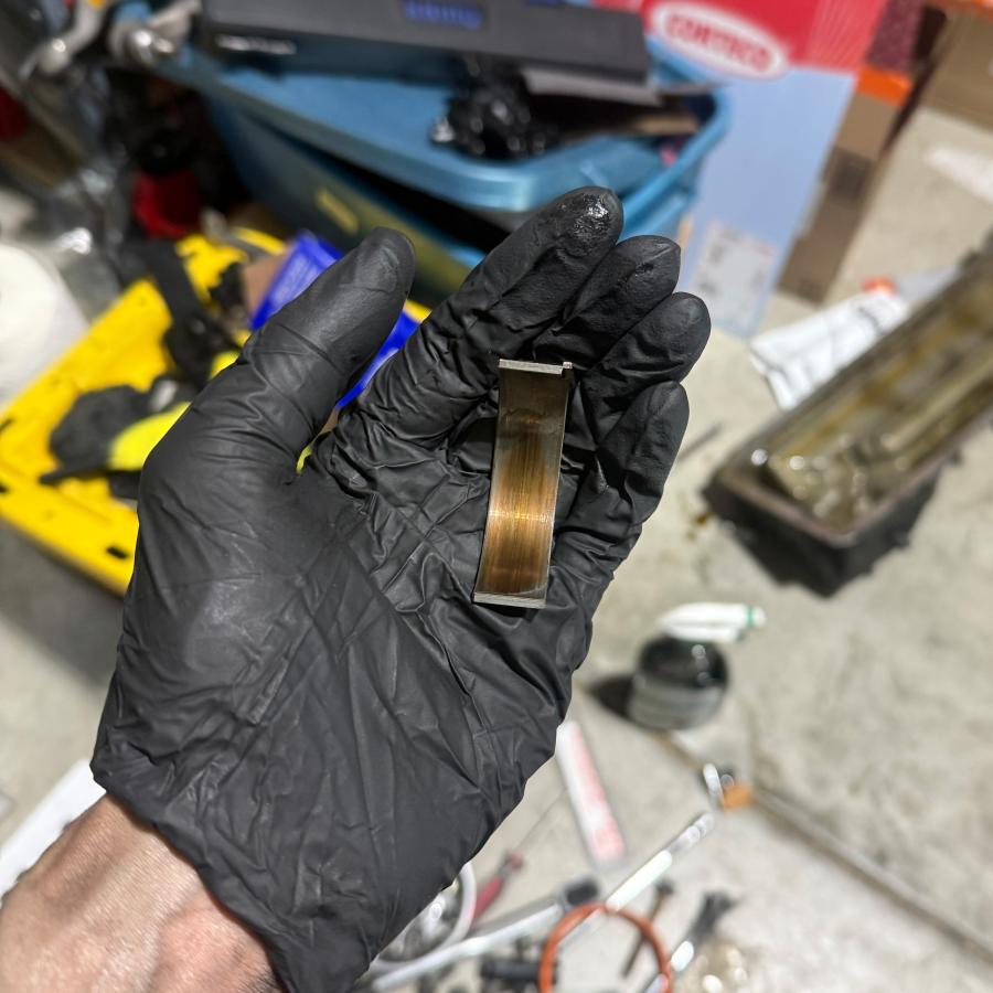

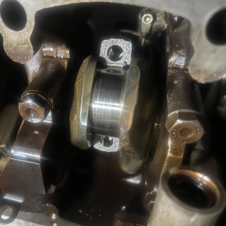

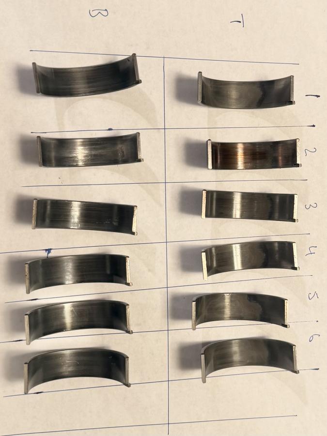

    New member here - just picked up a '05 E46 M3 with 109k miles on it recently. Just did the rod bearings this weekend and they looked as expected except for cylinder 2 which showed some pretty significant wear. There was also visual marking on the crank journal, however, it was not perceptible by touch. I have the new bearing on but the car isn’t reassembled yet, any opinions on me going back to pull that rod cap and polish the journal a bit? Link to photos if they don't load on this post: https://imgur.com/a/I9OaXVm

    If your fingernail didn’t catch I wouldn’t touch it.

        Fair - so far that's been the feedback from everyone I've asked. Next time I need to do bearings ill be pulling the engine anyway for a rebuild, just needs to not blow up for 50k miles of mixed use (track + street).

          I would cut some strips of cloth and pull the strip to polish the crank journal using chrome polishing compound.

            The chrome polish is exactly what I am considering, if anything just to take down any micro high spots.
              It's probably fine. You can feel insanely fine details with your finger so if you can't feel it I bet it's too small to matter.
