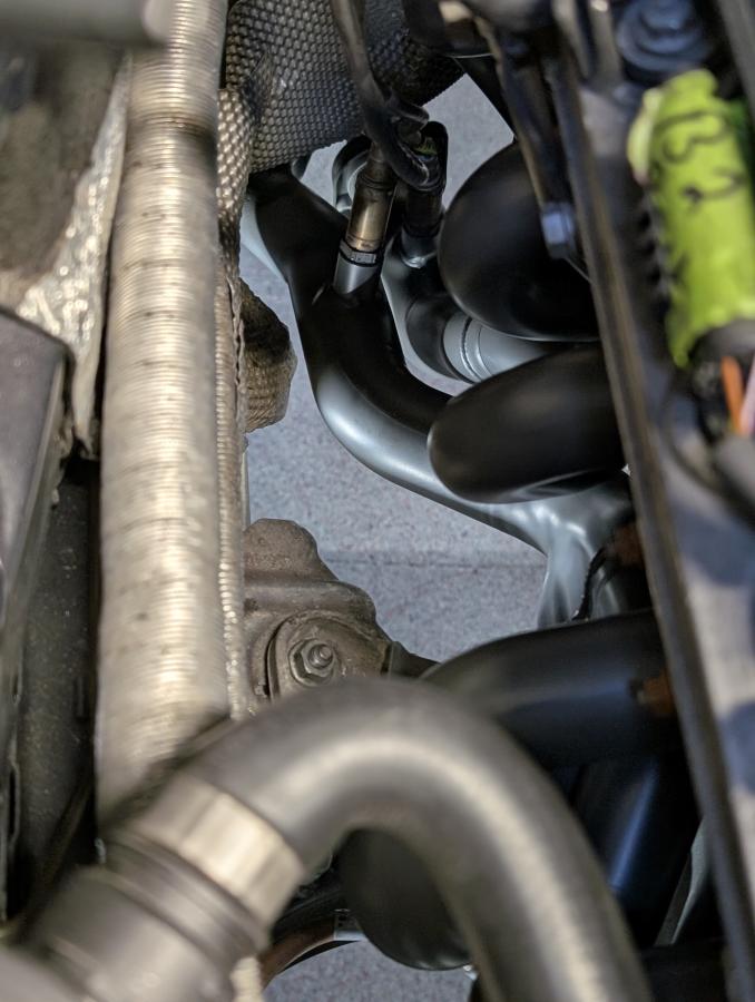

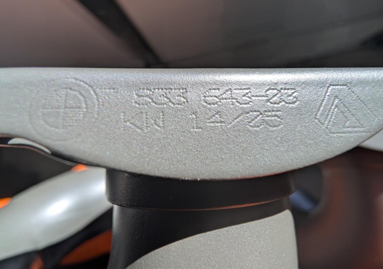

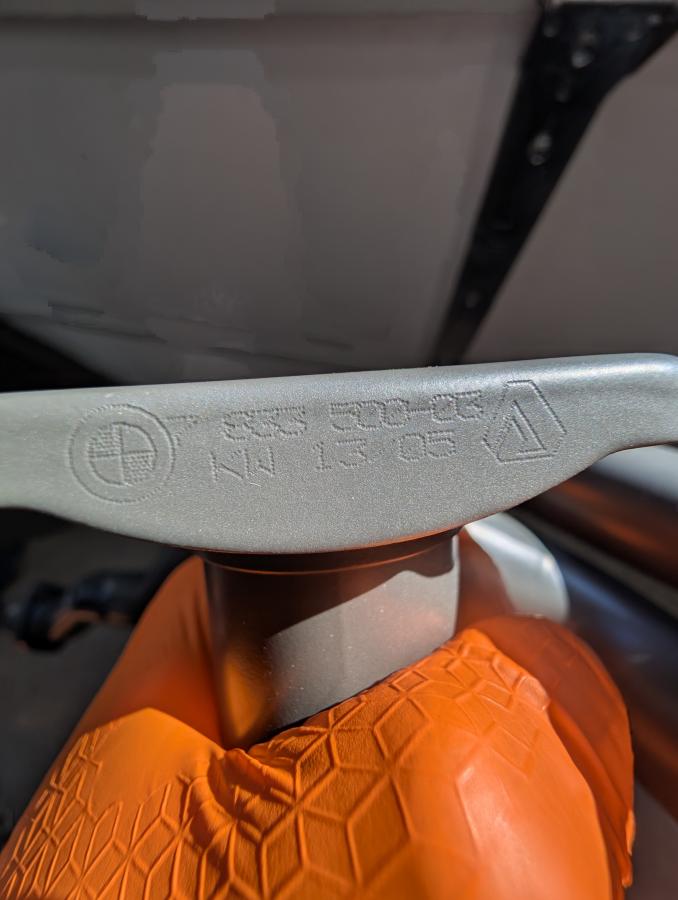

Installed euro exhaust manifolds on my S54 wagon

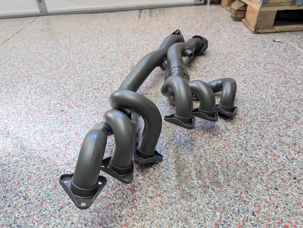

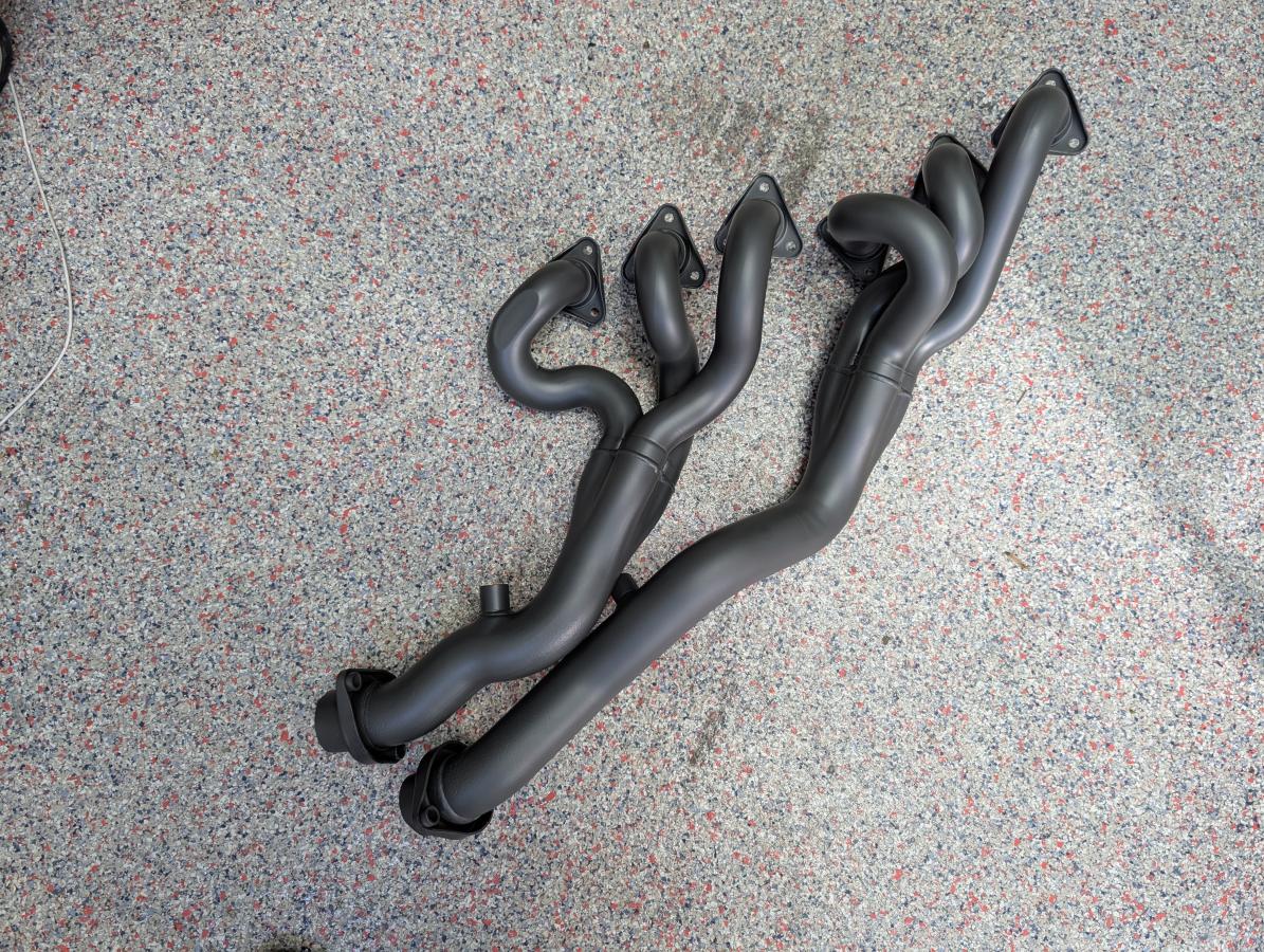

    Installed a set of Euro catless headers on the M3 wagon.
    Made a video about the progress. Cold start and driving video clips towards the end but if people aren't into the YouTube thing then here's a small short clip from that end of that video from Instagram

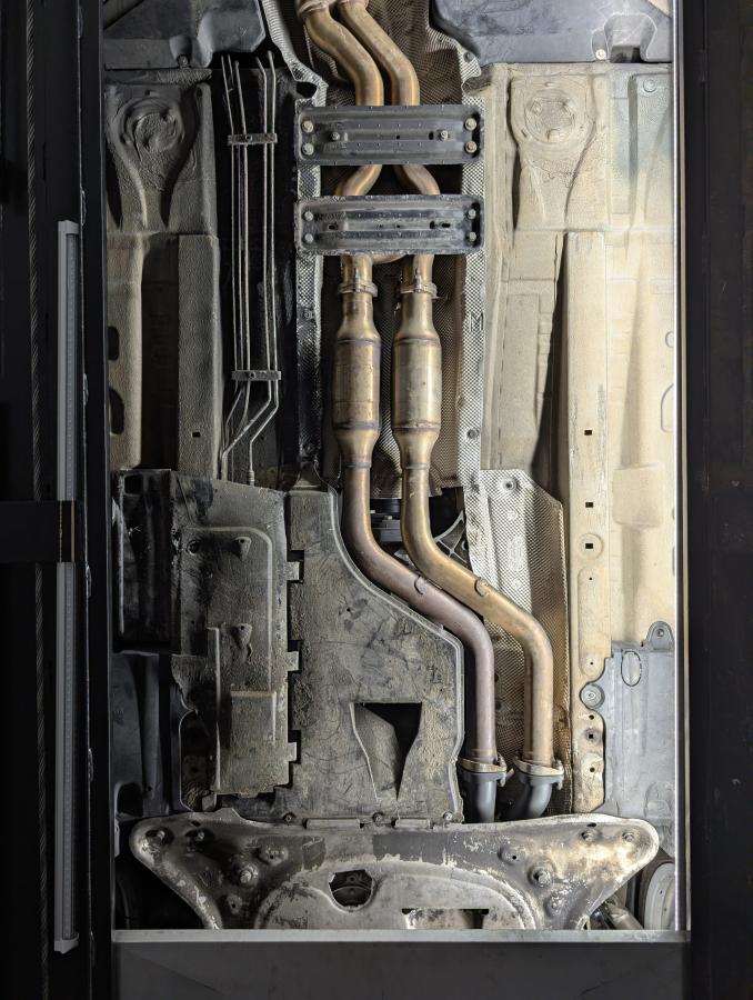

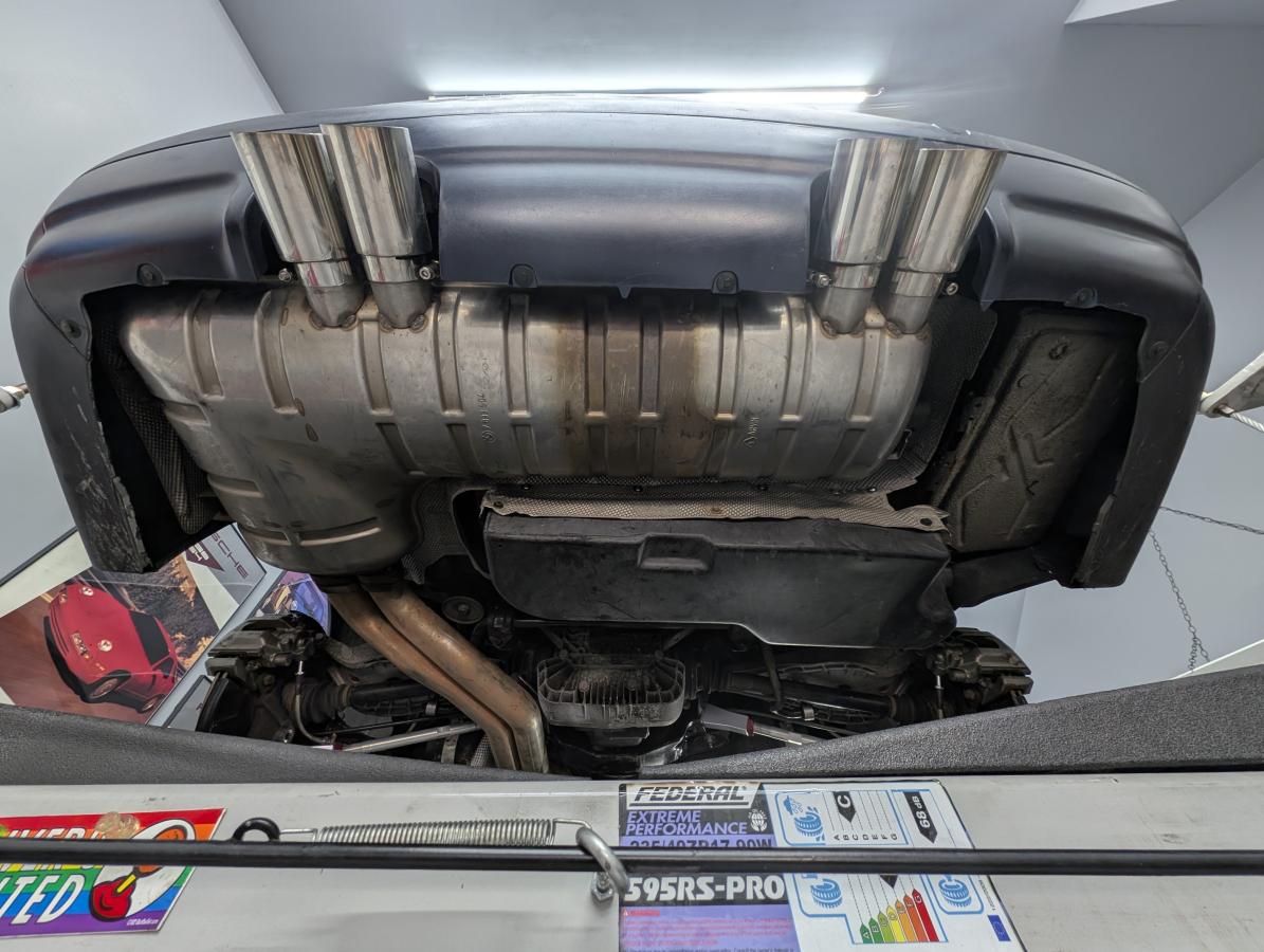

    Dual resonated section 1

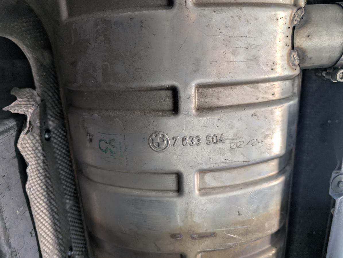

    Stock section 2 and CSL section 3
    Rasp as expected but I kinda like it. Looking forward to getting a 2nd wireless mic to put in the engine bay to get external audio of the exhaust and CSL intake simultaneously for a more authentic in cabin sound experience

      Euro cats really are the Goldilocks mod for the sec1. Flows well, controls emissions, muffles rasp but still maintains the natural metallic sounds of the s54
          In the video, I know it's pretty audible. It definitely has rasp but I don't feel like the rasp is the nasty rasp. I feel like it leans more towards the metallic rasp. At this point besides the stinkiness of no cats lol I don't really see a need to get the the expensive European section one with the cats. Or maybe I can try to listen to some videos of other cars that have them and see how they sound compared to mine
