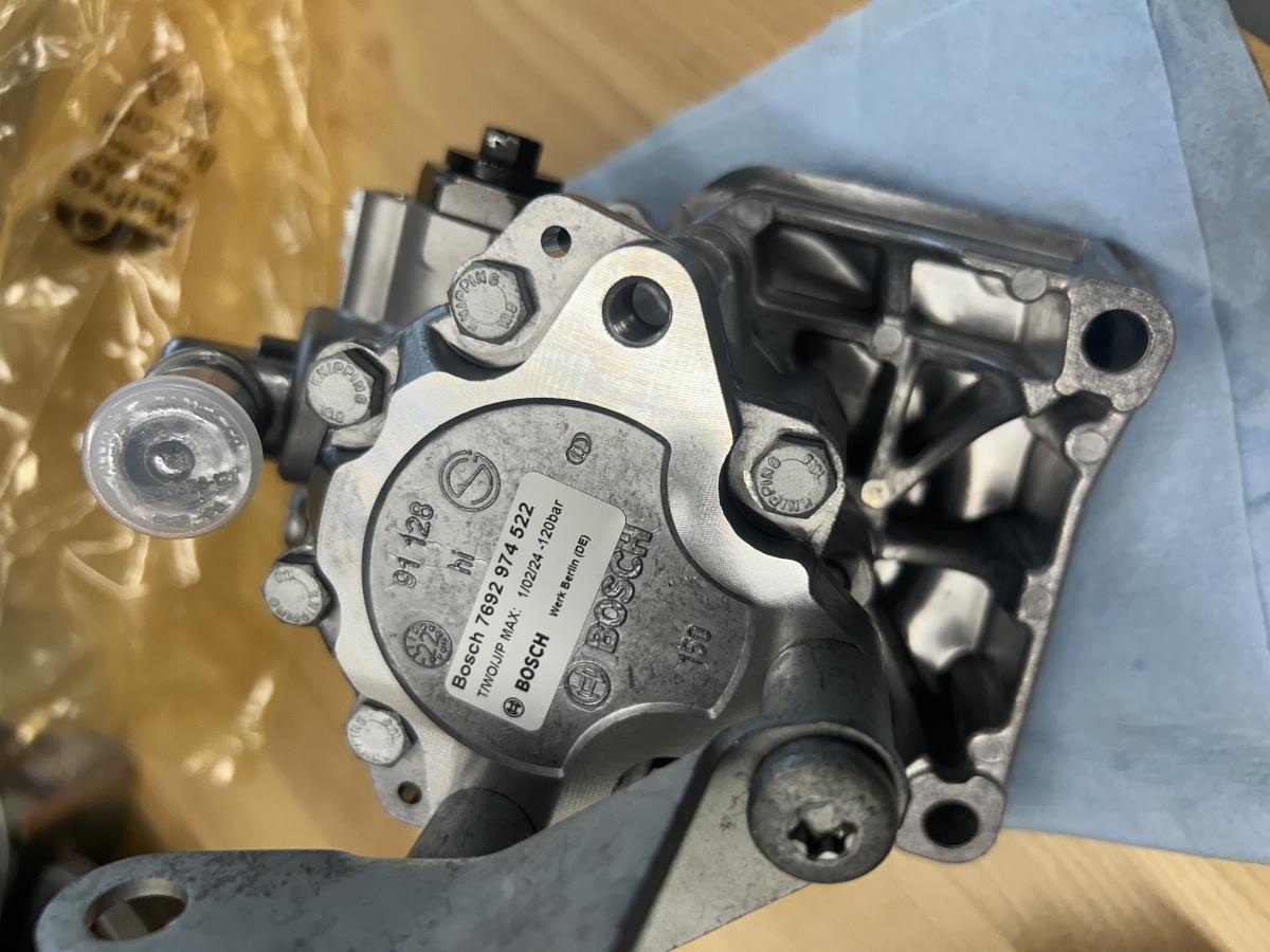

    I just bought a “Remanufactured Power Steering Pump - Bosch ZF 32412229679”
    ​FCP: https://www.fcpeuro.com/products/bmw...zf-32412229679
    This is what I received:

      Prolly so! I’ll have to go back to that other post again and read how. I’m considering keeping this as a spare - or doing a preventive replacement on my 175k mile original pump. I don’t want a failure on a track day.
      Also, of interest for this topic…based on what I see on the surfaces, stickers, and date stamps: it looks like the Bosch reman pump assemblies have used brackets, but a new pump (sub-assembly)
        I'd guess that Bosch simply changes the bearings and any seals or gaskets. I don't think they do anything with the pump chamber, impeller, endplates or the vanes.
