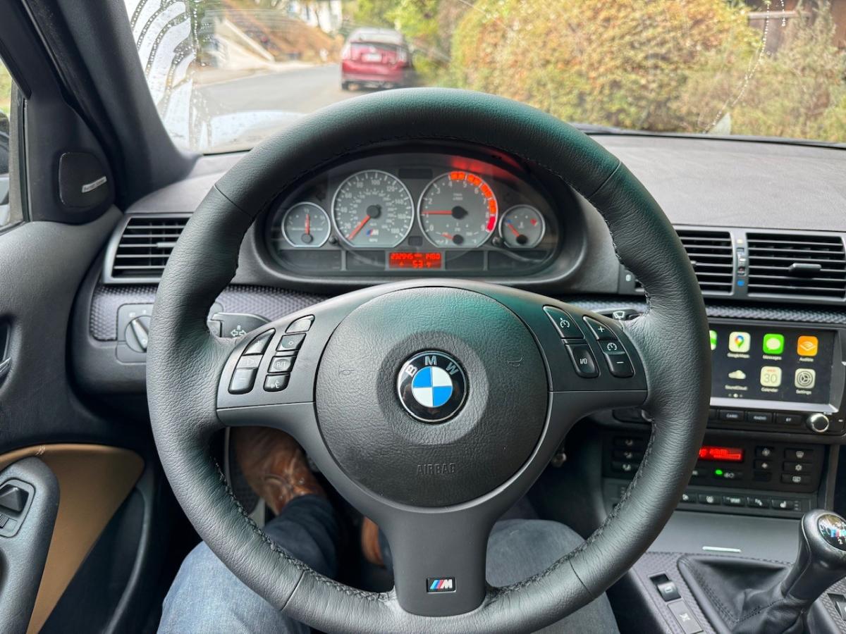

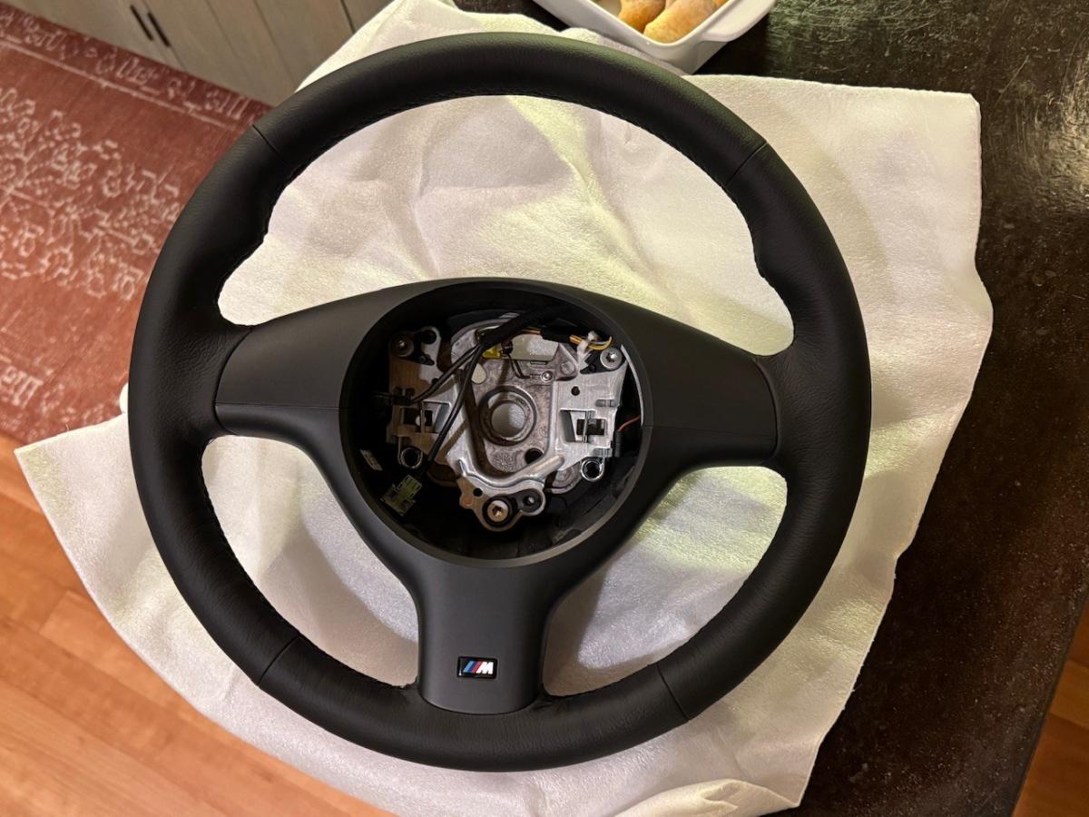

            I just bought an 021 for my car. Here’s what it looks like
ID:	289284 Click image for larger version

              Bry5on can you confirm that the 021 is the same diameter and grip thickness as the stock/original?

                  Yes it is. I replaced the stock M wheel with this. Naturally my leather had shrunk on the old wheel so this softer leather makes it a hair thicker, but that will be true for all variants.
