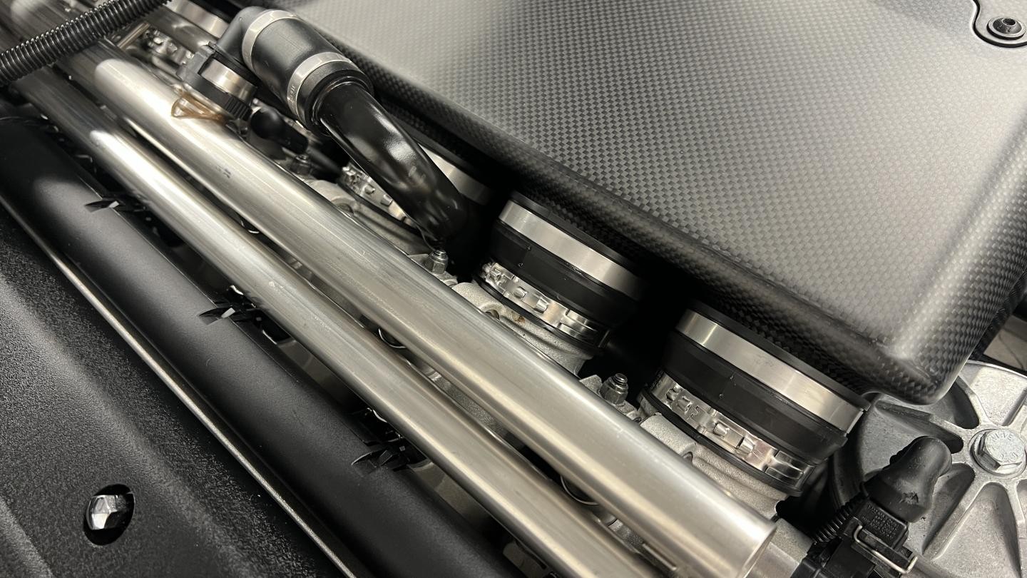

    Installed turner CSL box - all hose clamps have the worm drives in the 12 oclock position - yet at 50% throttle I am getting the egas error code and the car starts shuddering (at first I thought it was a bad plug or something, but INPA points to the error 230 egas)
    Its intermittent too - not every time will the throttle code throw
    I dont see where they are hanging up the throttle acutators - any hints?

      If you are using generic style worm clamps that require a tool to incrementally tighten them down, they need to be oriented in a very specific orientation to avoid this exact issue.
      The orientation can be found in many DIY's but its captured decently in this video at ~8:40 (LINK)
      The second (and better option in my opinion) is to use the factory clamps which have no "head". They can be found here (LINK)

        I would use the factory clamps, can be re-used on T.B side, looks a lot better, more even clamping force, no interference with T.B.
        The tool to install can generally be found locally as well. Same goes for airbox side clamps save being able to reuse them.
          I'm one of "those" people who use worm clamps. I know I risk banishment for admitting that here. lol
          But I always face the drive screw away from the throttle rod. Never had an issue.

            It’s fine from a technical standpoint if you make sure to orient them to not interfere with the throttle, but I also see the screw part really bite into the rubber and ruin it, but that might be down to user error / over tightening, who knows.
            To OP: just have someone else actuate the throttle while you look to see which one is hitting.
                Same. Nearly 3 years with zero issues. Just take the time to orient them, and test the throttle to ensure clearance. If I can do it, then anyone can lol
