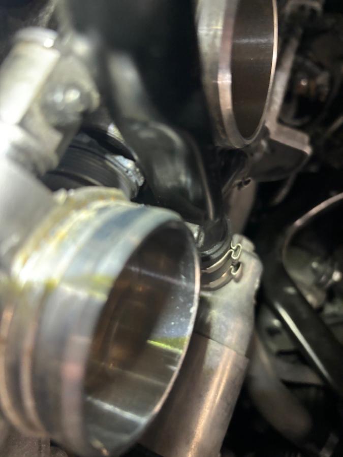

    So it’s this tube rubbing against the throttle I think
    I’ve tried bending it out away to no avail - anyone see this before?

    Ok the journey sadly continues here. To A/B test this I just totally removed the hose clamps - this is still happening.
    Hit full throttle - there is a moment then it begins to shudder and hesitate, then I get the "e gas" codes which I believe is TPS sensor and TPS position dont agree.
    At this point it must be one of two? things
    1. the HTE tune itself I put in is causing some sort of issue?
    2. I somehow damaged a portion of the throttle system when I installed the CSL intake (or the hose clamps that were on there did this) causing the throttle to catch and struggle when I hit full throttle?
    Any other ideas?
    The changes were install CSL intake, delete EGR, install HTE tune, replace vanos solenoid, replace both cam position sensors between when the car was working perfectly and now.....
    What do you mean by "delete EGR"?
    You can always reflash the tune and reset adaptations to rule out a software issue.
    There could be an issue with one of the three TPSs - pedal, TPS on the throttle bodies, TPS on the throttle actuator.
    If all three TPSs are good, then your throttle actuator is faulty.
    The only other thing that might mechanically limit the throttle bodies is one of bolts being loose for the air rail or something being stuck in/near the throttle bodies.
    Any other ideas?
