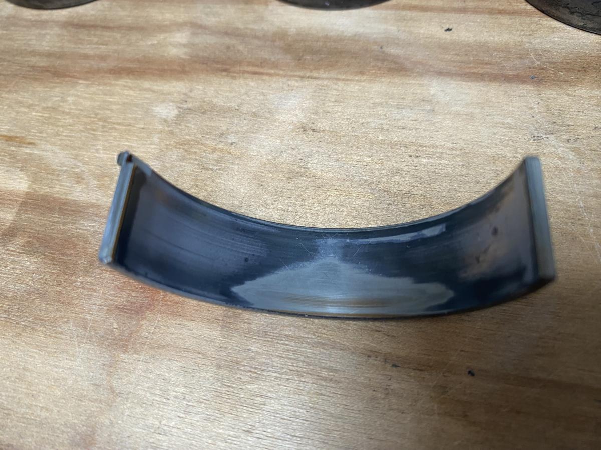

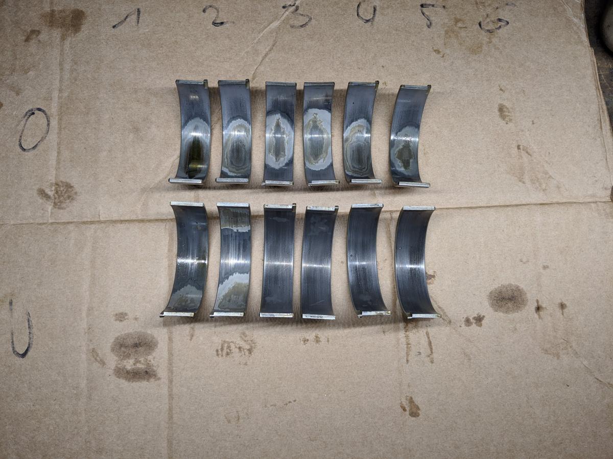

                    these oil tests are just time and money wasting. mine came back okay but the bearings didn't looked that great. i'm not doing oil tests any longer. regular oil changes, driving the car warm and cold and changing the bearings every 60-80k miles should be enough. these bearings are from a 116.000miles car. so yeah change your bearings asap.

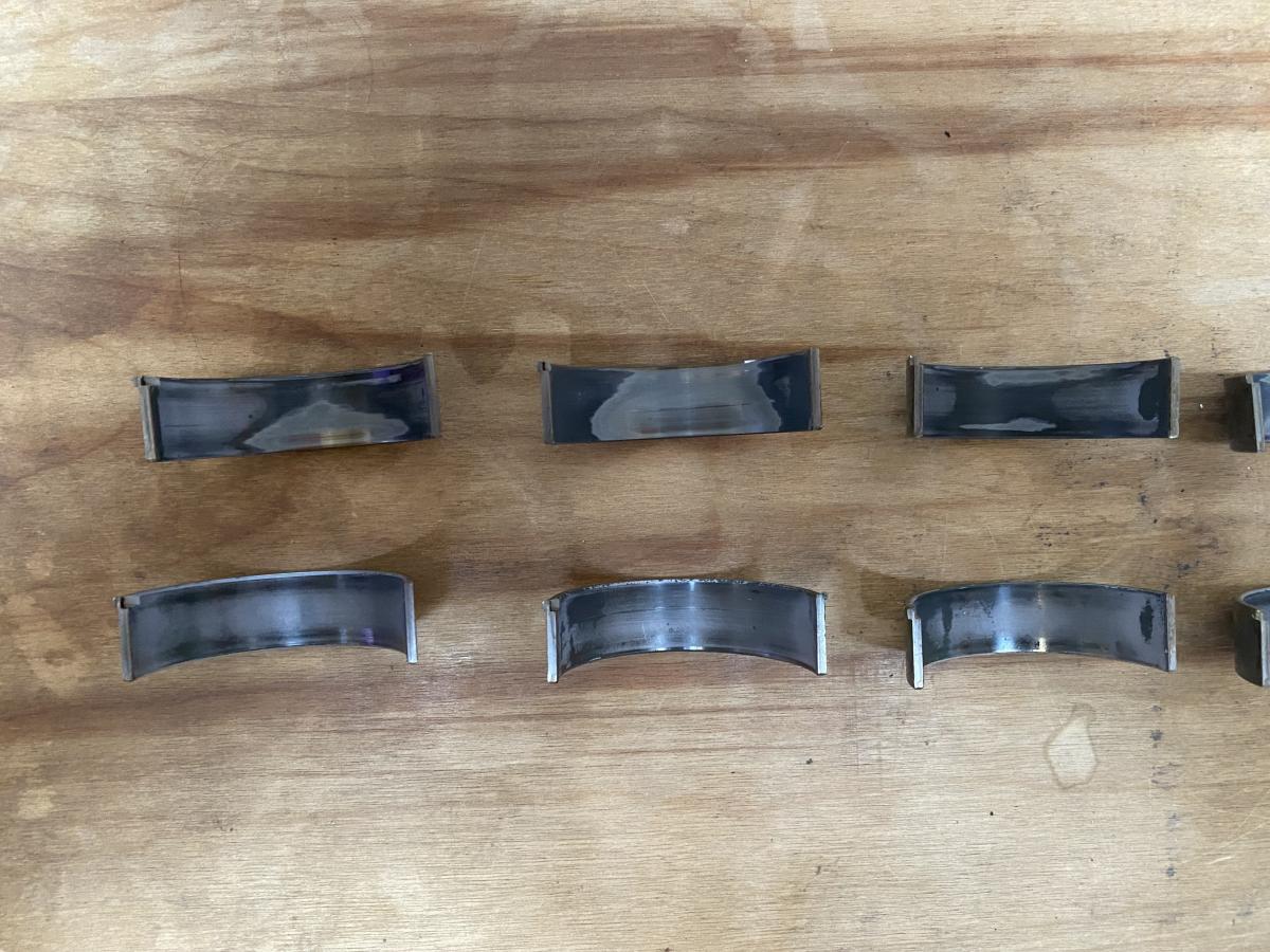

                    Can you confirm #1 is on the left and #6 on the right of pic? I believe it is, based on the offset wear to one side on the top shells.
                      Just bought mine at 92k miles and just going to do it anyways. Regardless of oil results.
                        Change them soon.
                          yes left to right, #1 to #6. and tops are top and bottoms are bottom.
                          2003 AW/BLK 6MT - Instagram

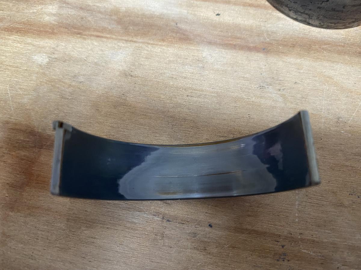

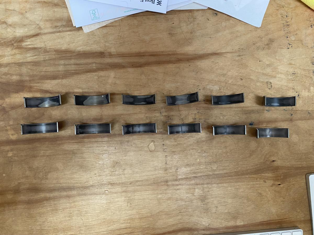

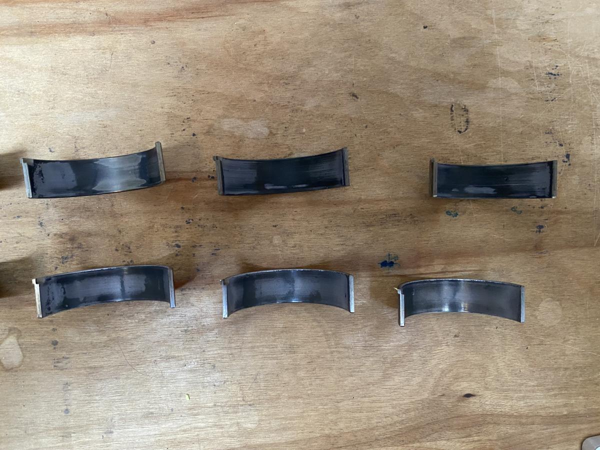

                            For posterity, here are mine. 1 and 2 starting to show copper, so it seems like the blackstone report was right on the money.
