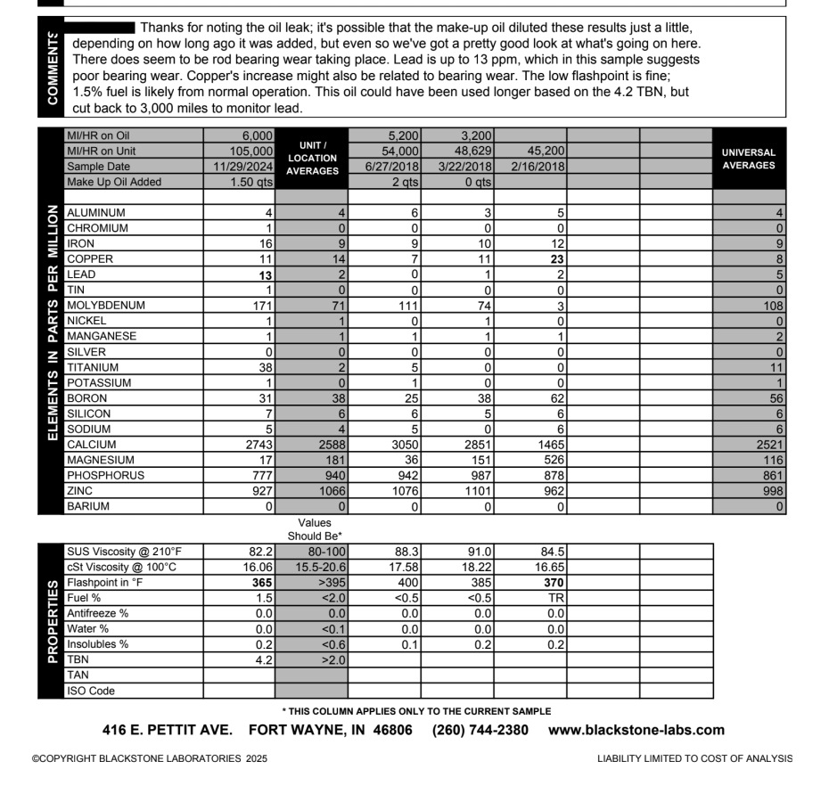

    Welp, after 60k great miles under my ownership, I've gotten an oil analysis result that indicates it might be time for rod bearings. Would like to get community thoughts in case there's significant leeway in how these results can be interpreted. Screenshot of Blackstone report attached.
    Car is a 2002 with 107k miles currently, oil was analyzed at 105k miles, so there have been 2k miles driven since the report.
    I have the full BMW service history of the car since new, it underwent the BMW rod bearing recall service really early on in its life, before 20k miles, maybe even before 10k miles iirc. So there are 80k-90k miles on the current bearings and they are BMW recall replacements. I've never been clear on whether the bearings installed during the recall had any better lifetime than the original factory bearings, but it seems like 80k-90k is about the correct service interval either way?
    This is my first oil analysis since 2018 when I bought the car, so no trend in metals to analyze.
    13 ppm lead: does this mean that I park the car now until I can get it done? It'll be a DIY whenever I can clear a weekend.
    About this oil sample: this was by far the longest I've ever run between oil changes on the car. I don't have exact numbers because I had too much going on in my life when I did the prior oil change to have written down the mileage. But my guess is that the oil being analyzed was in the engine for ~7k miles (maybe a bit more maybe a bit less). Typically I do ~3k miles, rarely up to 5k. FWIW, I had the valve cover off for a few days total during this oil interval, once for valve adjustment then again to redo timing, but I doubt that has any influence on the lead.
    I'd also had an oil leak throughout this oil change interval, so I added at least 1.5 qt of oil over this period, probably more.
    Given that I've driven 2k additional miles since this report: am I on borrowed time? Significant risk to drive the car any further? What makes me wonder if I'm okay is that the blackstone guy seems to be advocating that I drive another 3k and send in another sample, but that seems reckless.. no?

      So in reality, I've seen them blow out with that kind of oil analysis. And I've seen them be fine with double that. One of the intervals on your report shows 23ppm, and evidently they were fine.
      I can tell you though, I spun one with 15ppm. Didn't think anything about it, since they'd only been on the car for 1700 miles. Spun anyway. Point is, like sbay said, do it for piece of mind. Just don't use BE bearings.

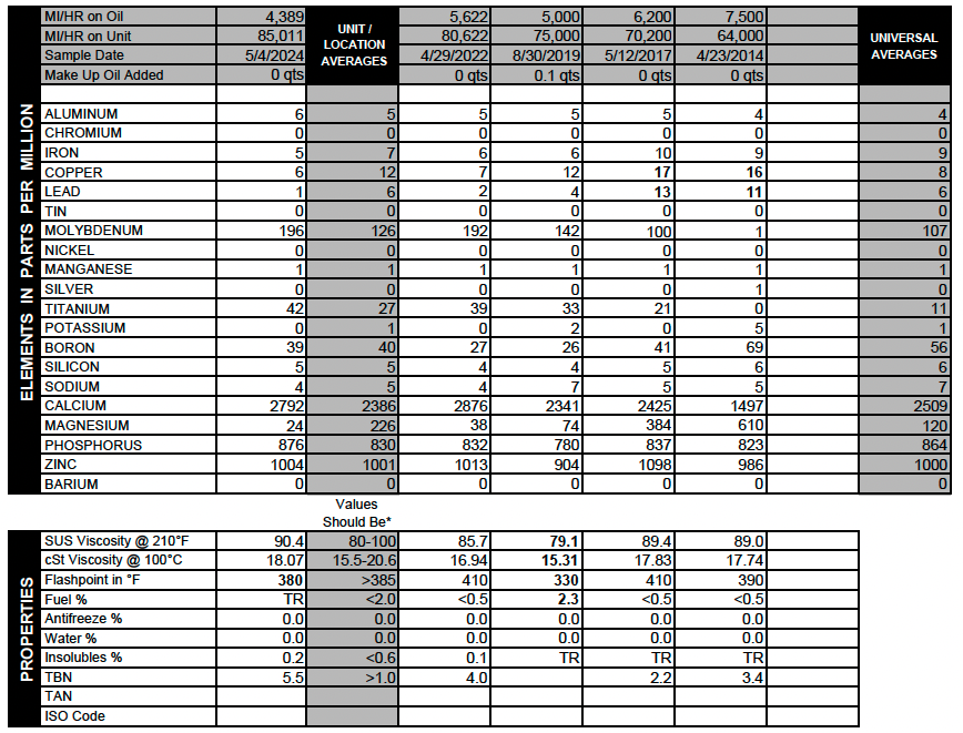

          Just my opinion, the Blackstone's advice on going 3K more and then test again is probably realistic because 1 data point doesn't make a trend. Now practically speaking, are you taking some risk? Sure. At 105k, if you have the resources to just do the bearings, eh, why not? Personally speaking for myself, I'd probably do the bearings because I have the (time/money) resources to do it. If you do go 3k more, please post results! I've had my Blackstone results fluctuate over the years....
Name:	Screenshot 2025-01-15 at 7.30.53 PM.png

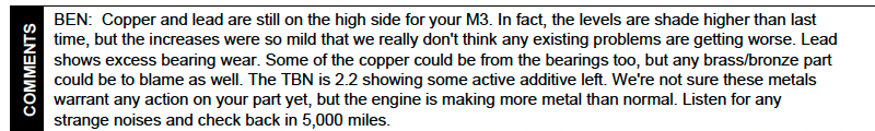

            If you need the kick in the butt, I had no rod bearing history / oil test results when I bought the car, and with testing under my ownership lead steadily decreased while copper was up and down across tests. When I finally pulled the trigger every bearing was showing copper – the lead values had decreased because they were THAT gone. The final test before I pulled them showed 16ppm copper / 17ppm lead – copper had risen from 10ppm to 16ppm between oil changes at which point I decided to stop playing with fire. The thing that Blackstone tests don't shed light on is the state of the bearings on each of the 6 rods – you're only getting an average and we know based on plenty of pictures that the wear rate is not consistent for all 12 bearings in the engine. And only one needs to spin to make your life hell.
            YMMV but there's the worst case, keep you up at night, scenario.
              Click image for larger version  Name:	Screenshot 2025-01-15 at 7.30.53 PM.png Views:	0 Size:	231.7 KB ID:	290746​
              Thanks for the data points. Funny that my analysts conclusion was "poor bearing wear" for numbers that were similar to yours, and I assumed you weren't getting such comments on your 70k analysis?
              I've actually already done 2k out of those 3k extra miles... I'm tempted even to just do an oil change now to send in a 2k mile sample as it's most of the way there and I've got that free FCP oil. If bearing wear is happening/worsening it should show? Included in these last 2k miles are many redline pulls and even the car's first trip to Tahoe! Finally got to use the ski-bag passthrough on my vert, and had a few below-freezing cold starts last weekend... kinda hurt me to do it every time lol.
                70k comments...
