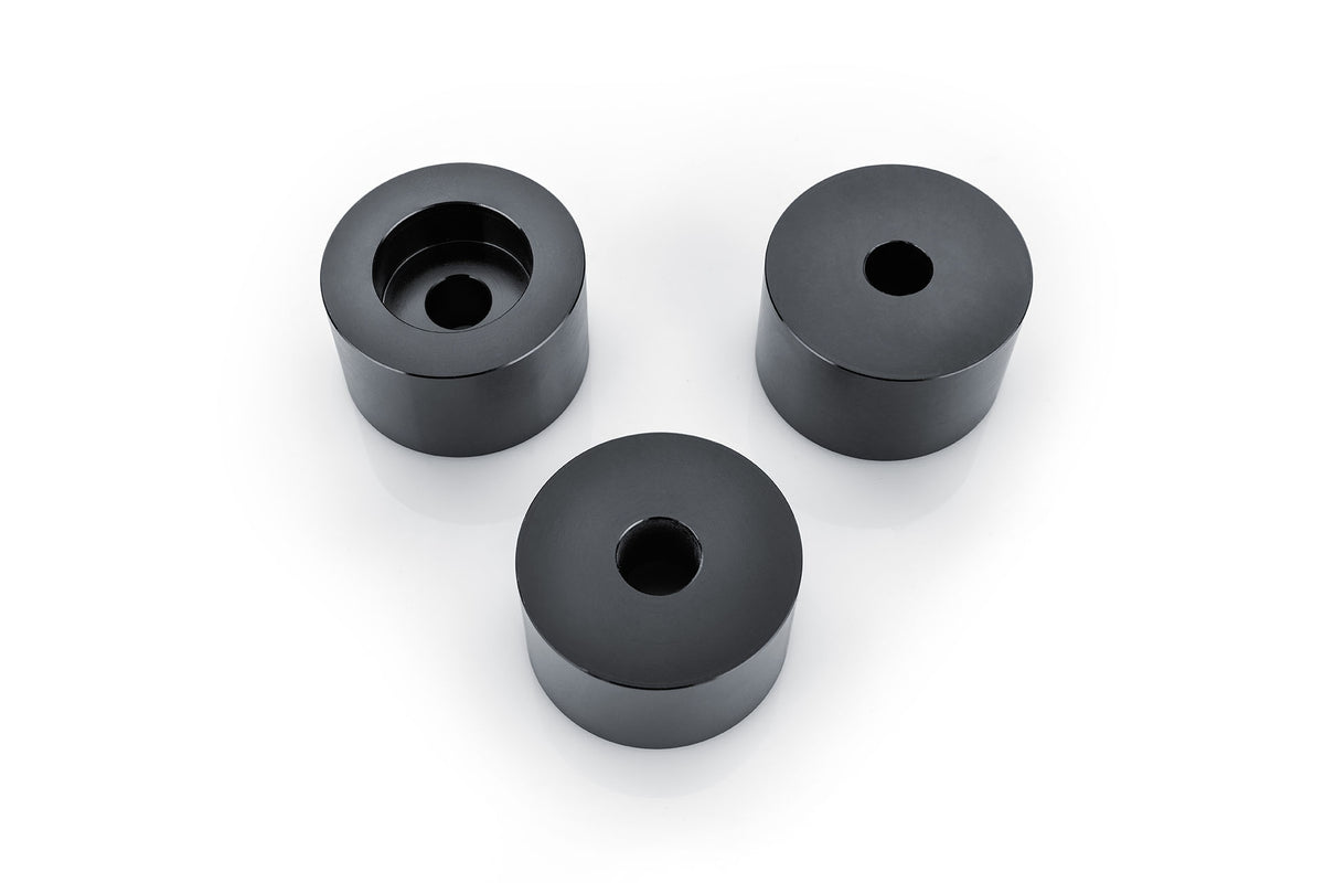

    Has anyone looked into or ran a diff lift kit on our cars? Noticed my right axle cv boot has a tear and while under there I noticed my axles are pretty angled upward towards the wheels, even though I’m not running a crazy low ride height (~12.75”). I had only seen these kits for the F8x platform, commonly installed for track oriented cars, especially those Nurburgring track tools overseas running really low ride heights (but also having kinetics/roll center correction as well I’m sure). Now looks like Team Schirmer made diff lift bushings kit for the E46 platform, and since I’m going to be in there for the axle boot repair I’m interested in trying this kit, but there’s 0 mention of it installed on anyones E46 anywhere online to get any feedback if worth it or not. And in typical TS fashion theres very little detailed info and vague description, doesn’t even say by how much it raises the diff lol. Price seems reasonable at least, though with any subframe/diff job the big cost is always labor..
    With our diff kit we lift the differential on the vehicle. The drive shaft can sit higher and has no more inclination. For a sustainable increase of performance in your M. Installation requires welding for E90, E92 and E82. Materials: steel, high strength aluminium alloy coated Product weight: 1,2 kg

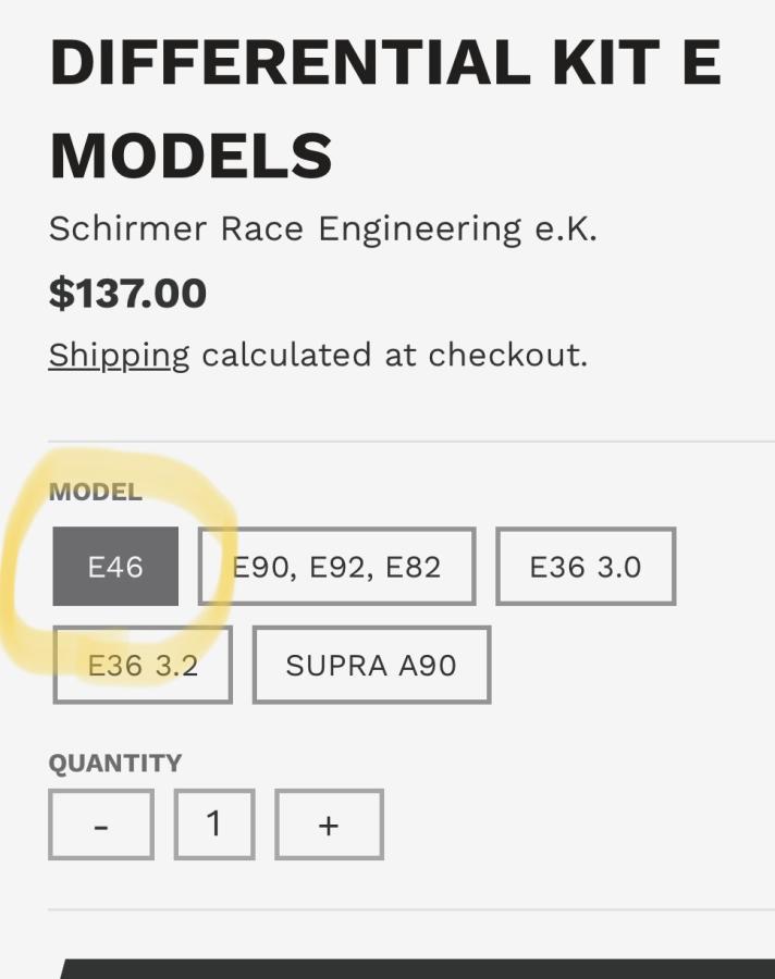

      What do you mean? Where did you see it’s not for E46? It says right there for E46 model, I have it selected on E46 here:
      Click image for larger version  Name:	IMG_0352.jpg Views:	0 Size:	48.6 KB ID:	291109
      And what you posted is a roll center correction kit, that’s not the same as the diff lift kit. What I’m refering to is a kit to lift the differential’s mounting so that the driveshaft axles are not so angled with the lowered ride height and are more horizontally straight like factory.

        Switch the site to German language and you see this:
        Achtung: Bei den Modellen E36 und E46 handelt es sich um zentrische Lager. Somit erfolgt hier keine Erhöhung des Differentials.
        And they would never sell a diff raise kit for that price.
        And yes it's just a roll center kit but you install this with their subframe bushing kit which sets the subframe higher and so the drive shaft angle. Combined you get the best possible angles as possible. But please correct me if I'm wrong.
        ​​​​​​​https://www.mk-motorsportteile.de/p/...fuer-e46-m3-z4

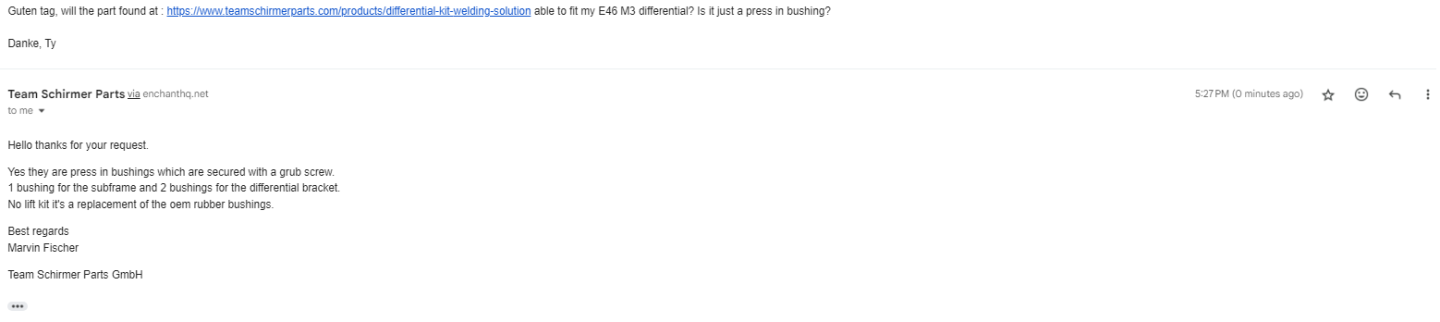

          Looks like no dice, just a diff bushing replacement kit
