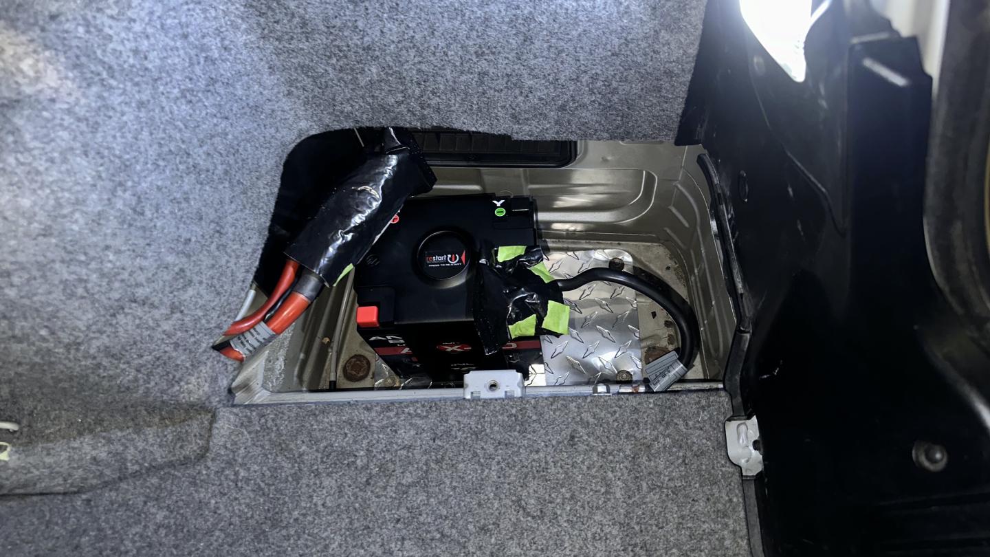

      Honestly not much feedback to give since I’ve only driven the car like 200 miles after the swap. I generally keep the battery hooked up to a charger. I’ve left it without charger for 1-2 weeks before with no issues.
      Last Dec the battery was draining quickly, and I think it’s been resolved with a new hood sensor. I can confirm that the battery’s restart feature works, and the car will start up without any problems.
      I removed the OE battery tray and used a lighter setup. This is the mount I used. Bolted it up to an aluminum plate, then secured the plate using the mounting points for the OE tray. Ignore the terminal covers in the pic…was waiting for proper covers to arrive.
                  Wow, so you definitely have alot of electronics still hooked up. I glad to hear that the battery has been holding up.
                  I plan on having the battery hooked up to a battery tender the entire time the car is in the garage. When the is used it will be driven then put back into the garage. It will never be a daily driven car.
                  Thank you for posting that tie down option. I have been looking for something to help with the tie down of that battery.
                  How much did that bracket weight?
                                I think this battery might be fine for your use case. Bracket is 9.1 oz according to their website. Don’t remember how much the aluminum plate weighs, but def not more than a few oz lol. IIRC the overall weight of the battery, bracket, and plate was around 7 lbs, and the weight loss was -47 lbs. Really good weight reduction mod IMO. If you decide you want a more plug and play solution, you could get the Antigravity H6 battery and reuse the OE bracket. I’ve seen a couple of used ones on Rennlist.
