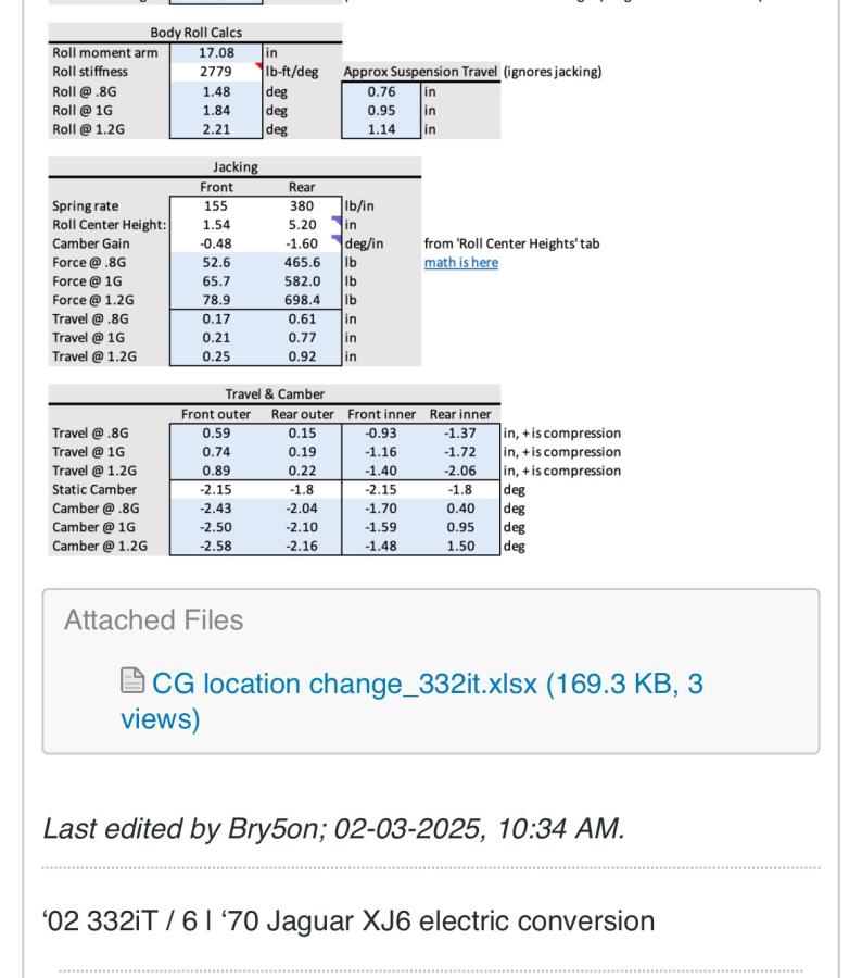

            You don’t see this? Looks like at least 3 others have. Man I’ve had so much trouble attaching excel files on here for some reason.
            No I see the spread sheet but it is just an image, it is just not a fillable spreadsheet.

                Must be the way you’re viewing the forum. I see it when logged in and also when not logged in using an incognito window.

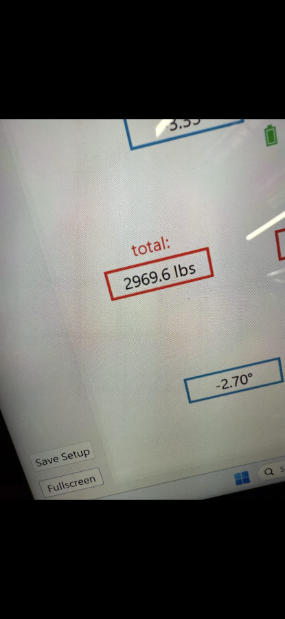

                    This is with the gas light on. Full OE csl inside and out down to the correct insulation.
                      This is extremely impressive and where I hope to end up.

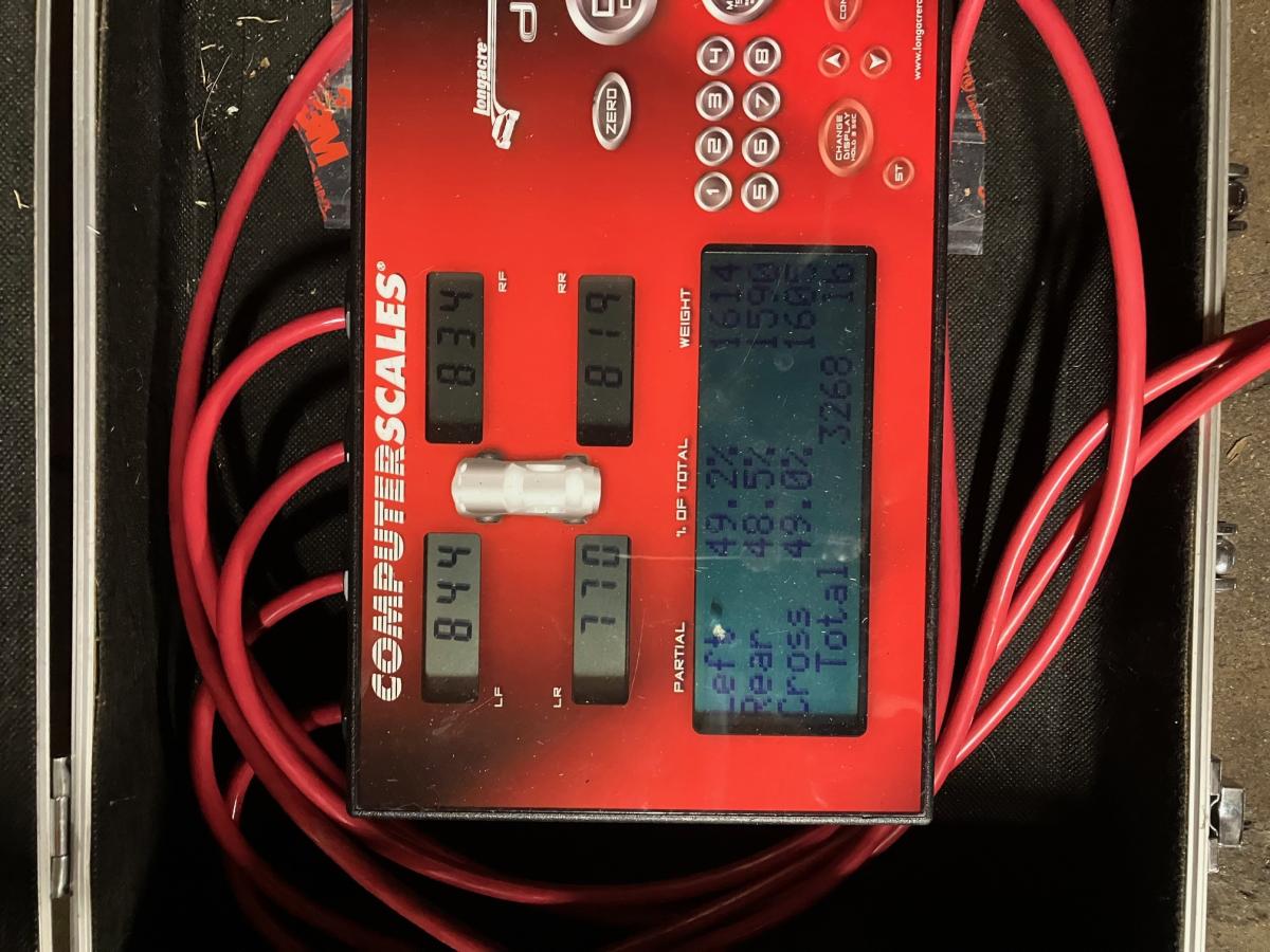

                        I need to reweigh my car soon. 3020lbs with 240lbs of ballast, I weigh 223, and 30l of fuel.
                        30l fuel x 1.7 lb/l = 51 lbs. 3020 - 240 - 223 - 51 = 2506lbs. I'm about the install a CF dash...so should be right at 2500lbs while slowly moving the CG rearward - 50.9% Front weight distribution.
                          Nothing too remarkable here. I assume this is what most street/track oriented cars weigh without crazy carbon everything.
                          ​Click image for larger version  Name:	IMG_3975 (1).jpg Views:	0 Size:	145.6 KB ID:	352804
                          Things that would change the weight from stock/when I got it:
                          6 Speed swap
                          Recaro Profis with Brey Krause brackets (drivers side is electric passenger is manual rail)
                          Vorsteiner CF Trunk Lid
                          SSR Wheels on 265/35R18 RS4s
                          ST40 BBK
                          MCS Shocks
                          Hotchkis Front Swaybar
                          Nardi Steering Wheel
                          Megan headers, bimmerworld street track exhaust​ (stock section 1)
                          Replica CSL Bumper
                          OE Halogen Headlights
                          Driver airbag was missing and they RTV'd over the airbag light when I got the car.
                          Bimmerworld Race Camber Arms
                          Everything else is how the car came from the factory.
                          I usually keep a jug of coolant and some quarts of atf and oil in the engine bay drug bin. I run with it on track like that, so I assume this weight is with that in there. I want to say this was half a tank, but I can't find my notes. This was with the stock airbox.
