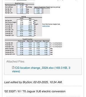

                    For some reason the spreadsheet is showing as a picture and not editable.
                    You don’t see this? Looks like at least 3 others have. Man I’ve had so much trouble attaching excel files on here for some reason.
