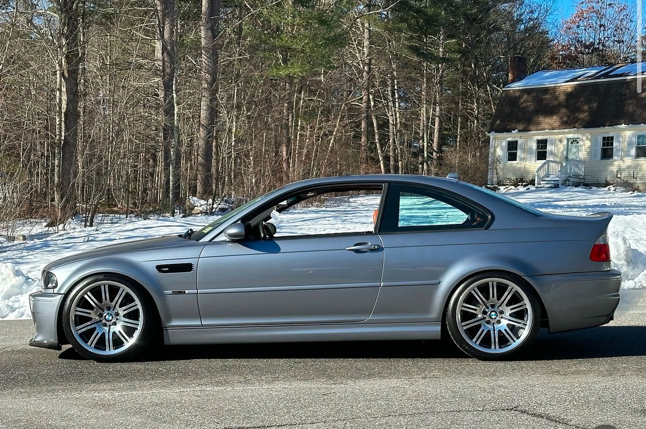

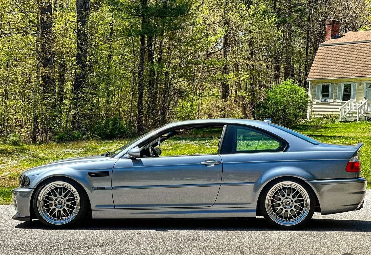

                          Swaybar isn't going to fix this. Post photos of your ride height and alignment specs
                            What arms and bushings have been replaced? Total mileage on chassis? Also curious about ride height.
                            Have you put it up in the air and checked each wheel for play?
                              Here is a couple pictures with the summer and winter wheels so you have a better Idea. I do t have the alignment spec. It was done beginning of last year since then I only drove 500 miles this summer
