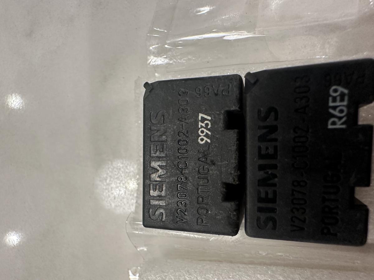

                      Siemens relay modules arrived today (put this order through before Sapote’s post about alternatives)
                      The face and model number are stamped. I believe the fake relays have a sticker or overlay of some sorts that is an easy call out.
                      I’ll post the Tyco ones when I receive them as well so others have a reference to ensure what they received is authentic.
                          Click image for larger version Name:	IMG_2686.jpg Views:	0 Size:	102.8 KB ID:	294096

                                My Tyco relays arrived today. As previously promised, here are front and back pictures of all 6 relays. Let me know what you think Riley
                                2x Siemens V23078-C1002-A303 – The larger relays that control the front windows:
                                Click image for larger version  Name:	Siemans Front.png Views:	0 Size:	856.5 KB ID:	294756
                                Click image for larger version  Name:	Siemans Back.png Views:	0 Size:	1.19 MB ID:	294758
