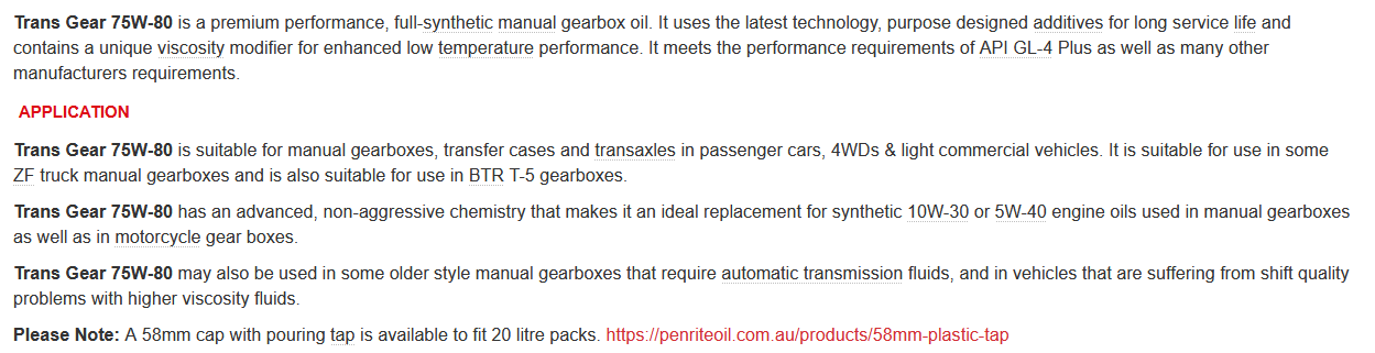

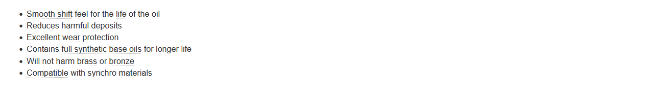

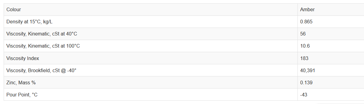

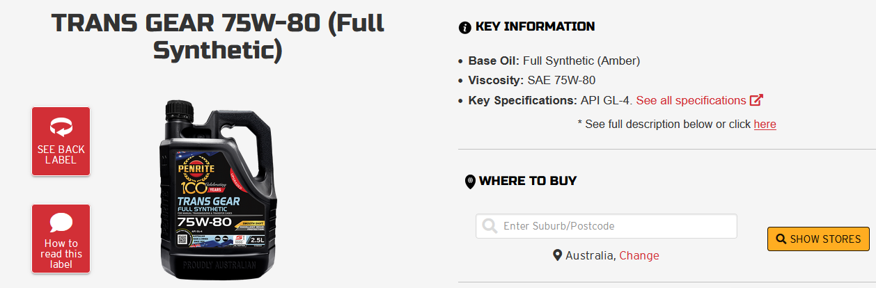

              I just started using this, mainly because it's a 'grab and go' off-the-shelf product for me at most auto parts stores and it’s produced here in Australia. Since I have an SMG, it’s a bit hard to tell, but I do recall on the first drive it felt like butter on the upshifts.
