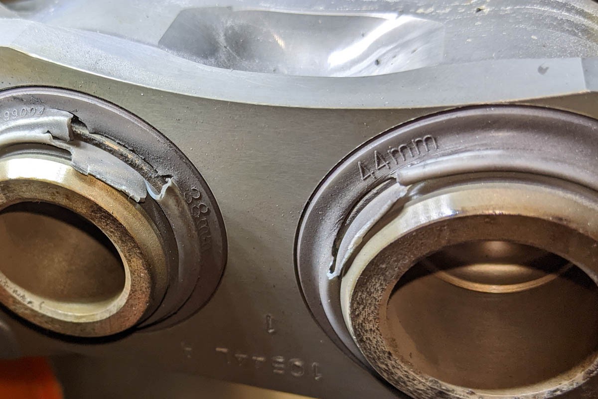

                    In the off-chance that your boots are still intact, it will have the piston size on them:

                      Oh perfect! Yea they are / should be intact. Thanks.
