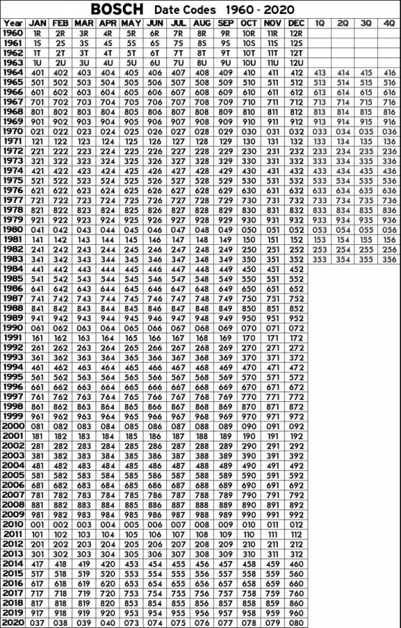

    There is also a way to date code a MAF. Generally it will have a nice little date code on the back of it for the 062 MAFs.
    However, there is another way to date them. I didn't know Bosch had this special date code thing.

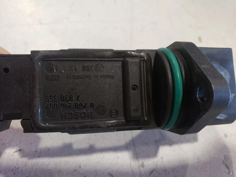

    You can see the usual date code thing on the back.
    Click image for larger version  Name:	image.png Views:	0 Size:	694.7 KB ID:	341581

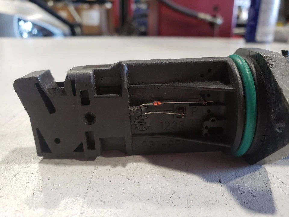

    However the "front" side has the date code we are curious about.
    388, So August, 03
    Click image for larger version  Name:	image.png Views:	0 Size:	709.6 KB ID:	341582
    I have gone around on Ebay and verified this works across multiple ones.
    This information shouldn't really be that useful for most people regarding the MAFs, since it has the date stamp on the back. However, found it neat so I'd share. ​
