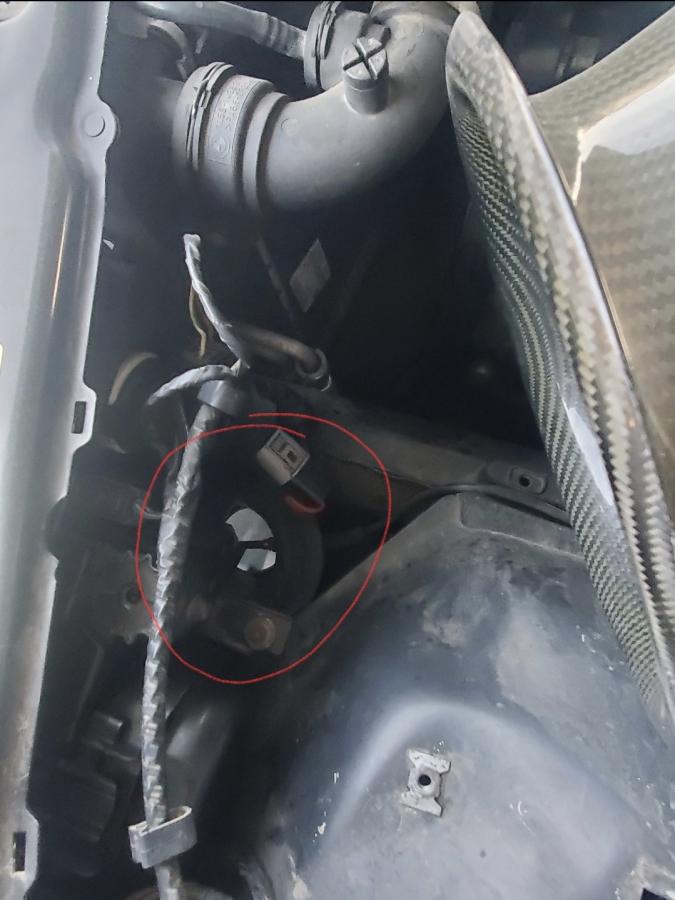

                            Probably a dumb question. Should the car come with "elephant trunk" duct where you insert and install the eventuri scoop? When i installed mine there was nothing there, just a hole.
                            I looked at Real OEM and i see something that looks like a duct, but its labeled as alternator duct #20
                              #44
                              yes on the M3s it has a “snorkel” to the duct. list as that part in (RealOEM). stock M3 airbox has another inlet at bottom. from your sig photo if you have a non-M you don’t have that on the Mtech 2 ducts. Although some E46 non-Ms do have an alternator duct for cooling.
