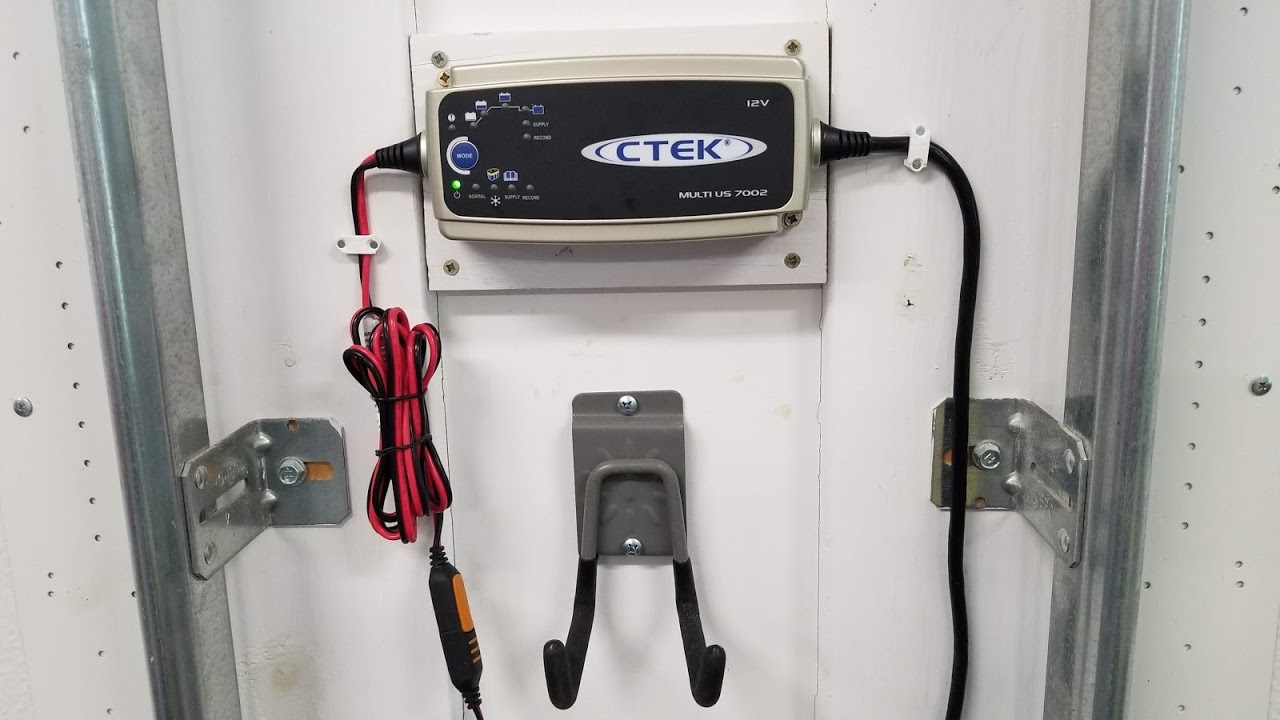

          CTEK 7002 is one of the best things I've bought, November 2019, and I should've have bought one sooner.

                              Using the CTEK 7002 I can run the full SMG adaptations, which takes 24 to 27 minutes, in power supply mode without issue. Make sure battery is fully charged and in good health prior to starting whatever it is you are doing and you should not have any problems.
