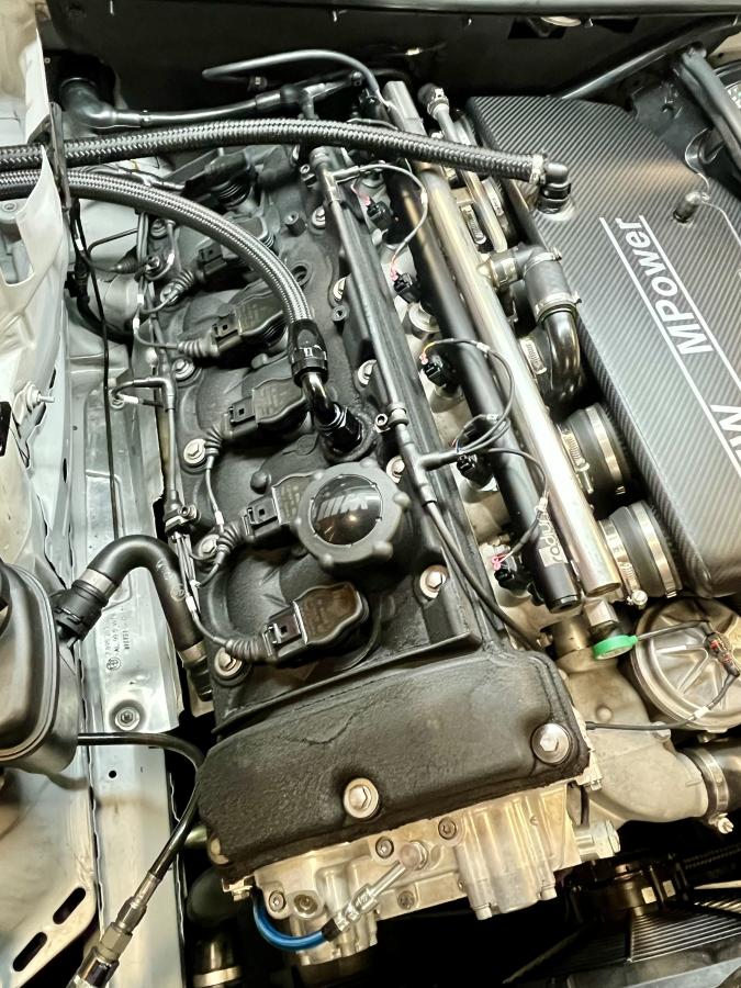

      Nothing

          Nice setup! Did you tap the valve cover for an AN fitting?
          What coils are those?
            Thanks.
            I had the valve cover milled and welded to fit the Bosch coils. They are the Audi R8 coils. They come on a bunch of different VW cars. I went with those because they have the igniter built into the coil.

                  Nice wiring harness !
                  If you did it yourself, you did a hell of a job.

                    Harness was done by me. Appreciate that.
                    The engine harness was easy in comparison to the chassis harness. That one took about 3 times as long.

                      Proper Planning Prevents Piss Poor Performance.
                      Wiring is more than 50% planning, execution is the easy part.
                      Seems that you got both covered 😎
