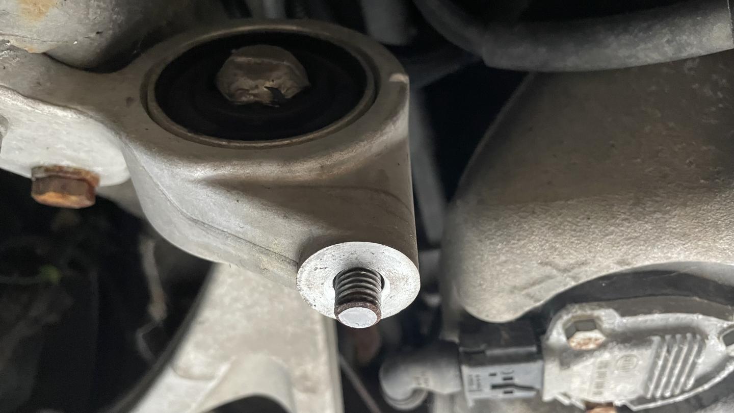

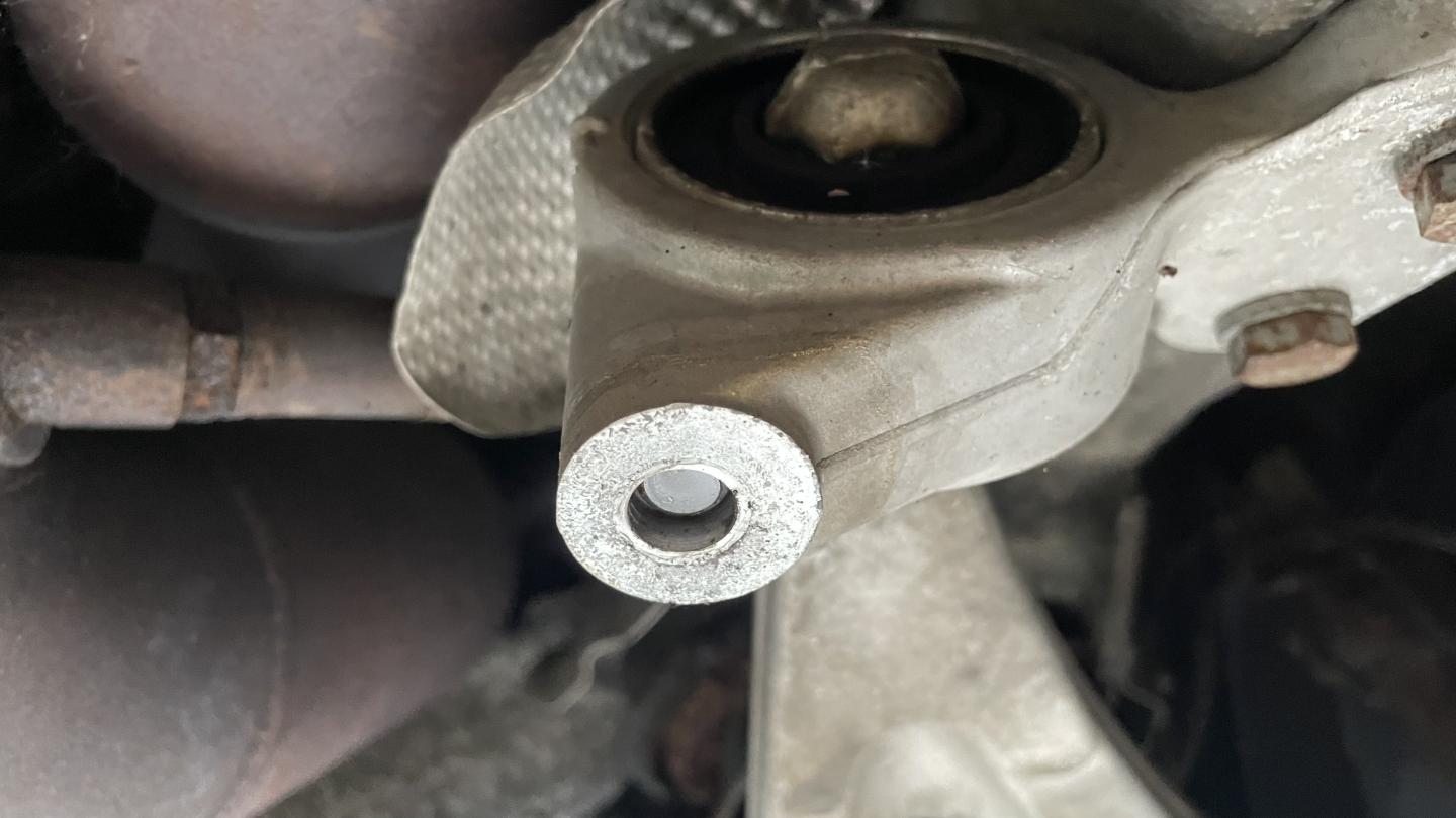

ID:	315249 Welp, i think I might be adding FCAB’s to the list. All of those torque to yield bolts came out easily except the two that go into the FCAB’s. Both gave me a hard time - the passenger side snapped right away and the driver side snapped just as I thought it was almost out. I guess galvanic corrosion between the steel bolts and the aluminum popsicles on top of the steel bolts being torqued so much. I’ll try drilling them out with reverse drill bits but I suspect it will be a lot less hassle to just replace the lollipops with the old ones I had before these were installed, and press in new bushings.
                        Did you use an impact by chance? On those I typically hand loosen.
                          It was a combination of hand and impact. I started with the passenger side and it wouldn't budge with a breaker bar, so I switched to my DeWalt impact on medium setting and it started to budge, so I worked it back and forth until it started to move noticeably. Then I switched back to the breaker bar and while turning it back and forth about half a turn, it snapped. When I tried the driver's side, I ended up using the impact most of the time, switching to the breaker bar a quarter turn back and forth to free it up when the impact got stuck. Again, it was when I was turning with the breaker bar that it snapped, but at least I got it about halfway out. To be honest, I could have been a little more patient, but it was 34 C feeling like 44 (111F), and I was drenched in sweat and being showered by rust dust.
                            Honestly you can just install the underside tray when you’re all wrapped up vs. buying new FCABs unless you know they need to be replaced. You won’t lose any protection or strength by not having those two bolts securing the plate to the underside of the car because there are 10 other bolts!
                              You got off lucky. Just weld a nut on to the end and heat up the FCAB housing a bit.
                              Before you replace the crossover lines, check the rack pinion seal. That is a far more likely leak point that the hardlines.
                                That would save me a lot of time and those bushings are practically new - sort of (they might only have 500 kms on them, but were installed about 5 years ago just before I stopped driving it regularly). Since BMW calls it the "suspension subframe reinforcement plate", and the only part of the suspension that connects to it is the FCABS, I figured it was important.
