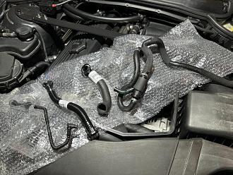

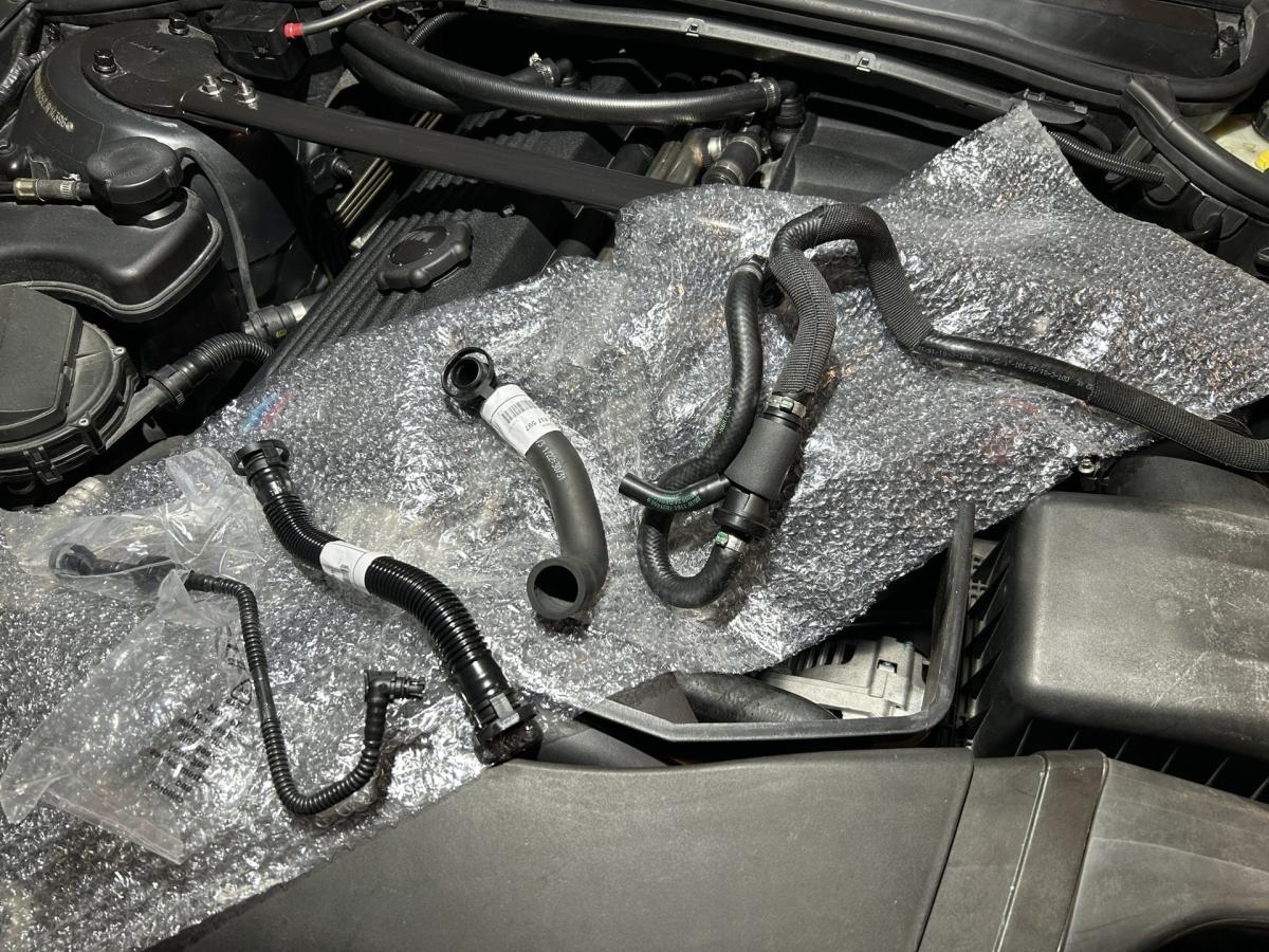

                          My 2002 M3 (130k miles) is also having the same issues in these 2 years, same high LTFT (15-20%, but no CEL) and did smoke test and no results, so today I decided to replace all my vacuum-related lines with new BMW parts in (documented in my E46 fanatics post) and I hope this is going to fix my leak.
                          Vacuum Leak Line
                          1. airbox to oil pan drain hose (known to crack easily)
                          2. sucking jet line to brake booster
                          3. IACV elbow hose
                          4. cyclone to airbox cross tube
                          5. SAP to head hose
                          6. brake booster to jet sucking line grommet
                          Prior to this, I have also replaced my coil, plugs, fuel pump, cleaned my fuel injectors, new both pre-cat O2 sensors, new injector & air connection pipe seals & o-ring, replaced the cyclone, valve cover seals & gaskets and etc..... basically anything that has a SEAL involved, I have already replaced. This is driving me nut but I am not giving up.
                          I removed my catch can and reseted my adaptation (basically my setup is stock) and drove 20km today the LTFT is starting to climb up to 6-8% in both banks, but will report here again after 200km.
                          I swear if these measures can't fix this, my last resort will be replacing the brake booster.
