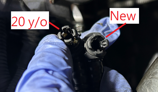

    One thing that I would like to share is the airbox oil drain. The 20+ year old drain tube fitting is noticeably smaller that won't seal very well to the airbox after years of heat cycle.
    I highly recommend to replace it no matter what just for the peace of mind.
    Click image for larger version  Name:	image.png Views:	25 Size:	225.2 KB ID:	306532​
