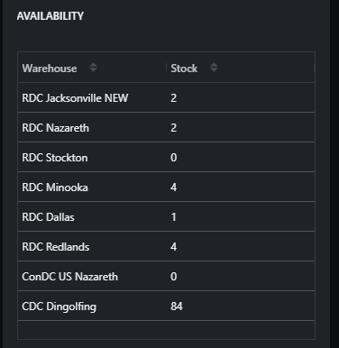

            Looks like 13 in country, 84 in Germany.
            Unrelated, but can you see if the diamond keys are coming or actually NLA?
              They're still on indefinite backorder. Still an orderable part so not officially NLA. AFAIK there was a supplier issue but that could just be a rumor. We've had some on order going all the way back to August.
