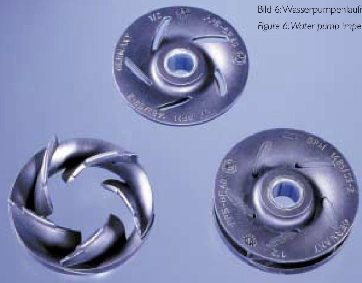

        Yeah but…….noooooo….…the oem pump has a 62% increase in flow efficiency in its best point in comparison to the s50 pump. This is needed for the cross flow coolant design that the S54 utilizes (more flow needed). Therefore it’s stupid to compare S50 and S54 coolant pump and especially metal impellers. Metal impellers will simply not bring the requested flow.
        Also you brought in valid points but got to the wrong conclusion. Flow is extremely important. Many of the coolers actually try to improve overall coolant flow by reducing flow resistance and more importantly you basically also said that the oem pump flow is so good that it’s not the „bottleneck“ in the cooling system, because if it would be people would change it‘s size/pulley size.
        The oem pumps are great quality and the plastic impellers normally don’t explode for the S54 unless your bearing is already so worn out, that it starts to wobble. This actually happens to most people but then instead of finding the root cause the say ….“oh noooo……plastic badddddd….want cheap metal“ like freaking caveman.

                        Not sure if it was already mentioned, but here’s another reason to avoid a metal impeller. One time on non-m e46, the bearing broke on my water pump which allowed the shaft to come out of place and move a great deal. The composite impeller inside struck the inside of the water pump housing inside the block, and broke onto a bunch of tiny plastic pieces.
                        Now imagine what might have happened with a metal impeller, possibly chewing metal from the block, causing irreparable damage.
                        After experiencing that first hand, I’ll never even think about a metal impeller.

                            I mean there is empirical data. According to BMW the Plastic impellers achieves an overall effectiveness of 62% in its best point. Also according to bmw this is necessary to achieve the flow required for the cross flow cylinder head design……
