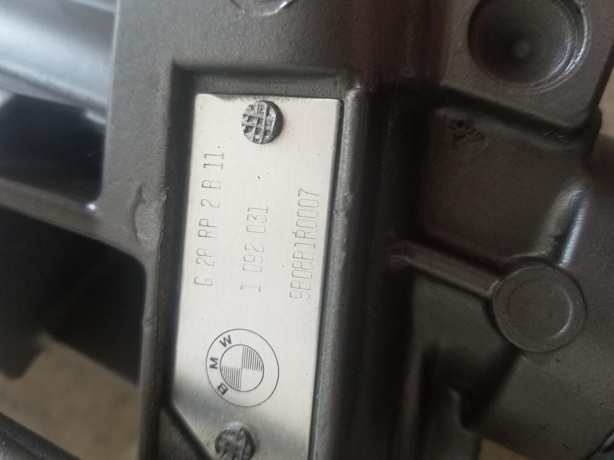

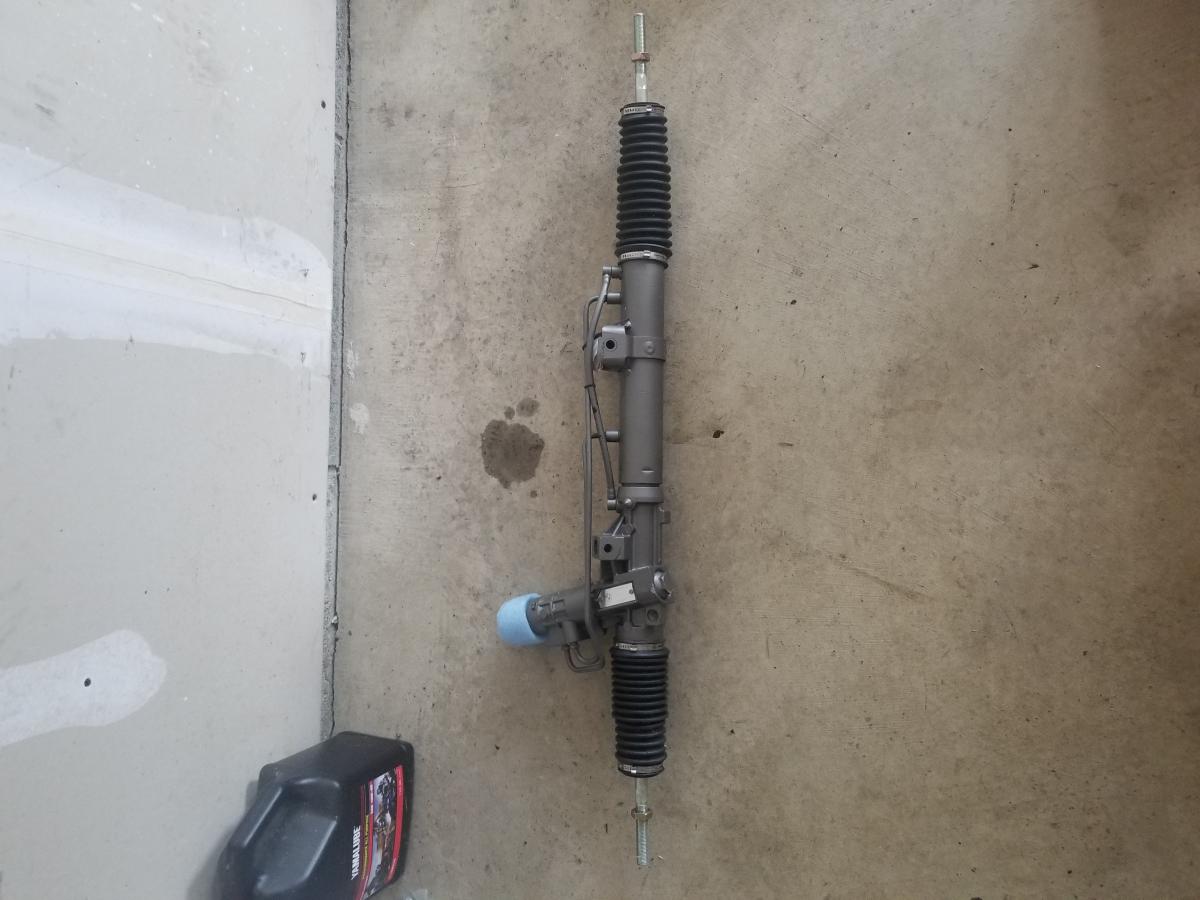

                          I have a brand new rack I believe from a z3. My friend gave it to me years ago and I forgot about it. Would these work in our cars?
