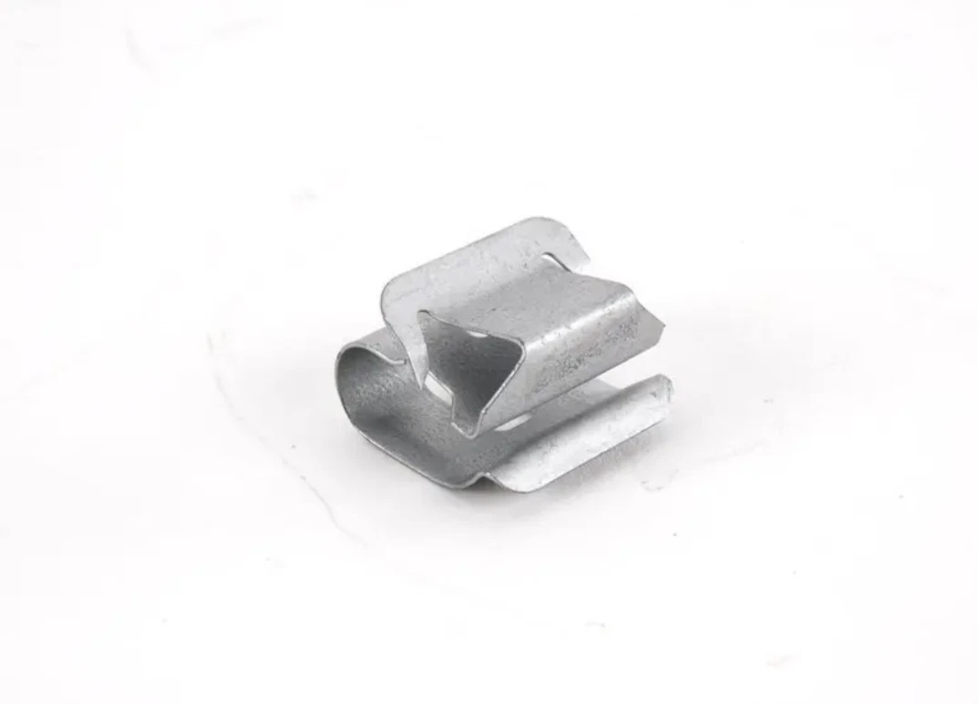

            On the heat shield above the headers, there are two metal clips that hold the pre-cat sensors away from the headers. The factory routing is the best for those two. For the post-cat and EGT, those are going down the driver's side of the transmission along the transmission tunnel where there are plastic clips that hold the gear position and trans temp sensor wires. Once the wires get to the transmission tunnel heat shield, they can be clipped to the transmission tunnel heat sheild using those same clips found on the header heat shield - probably need 4 of the metal clips.
            This method of using the clips looks factory-ish and the O2 sensors will be easily removable when it comes time to remove the exhaust.
            If the plastic bracket on the Euro cars that holds the post-cat sensors was readily available, that would be the best option, but one or two of the metal clips (pictured above) is still required to clip and hold the post-O2 sensor wires above the cats.
