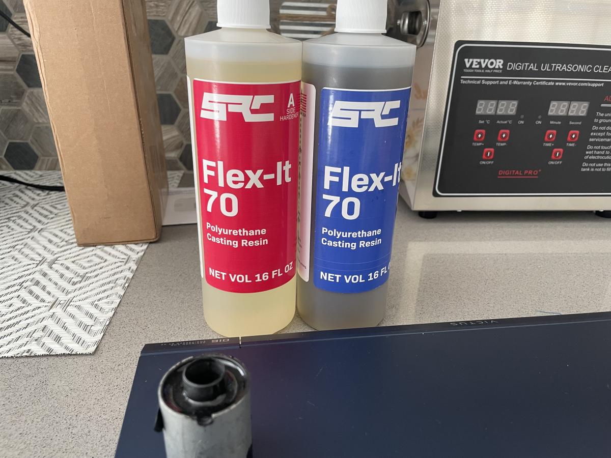

    the syringe is convenient as you can measure equal amounts by volume rather than weight. It only took me 3ml of each part to fill the void of the bushing that faces the front of the car. You could fill both sides if you wanted to but I want a noise free solution so will first try with the most relevant portion of the bushing.
    here the products in question and the filled bushing.

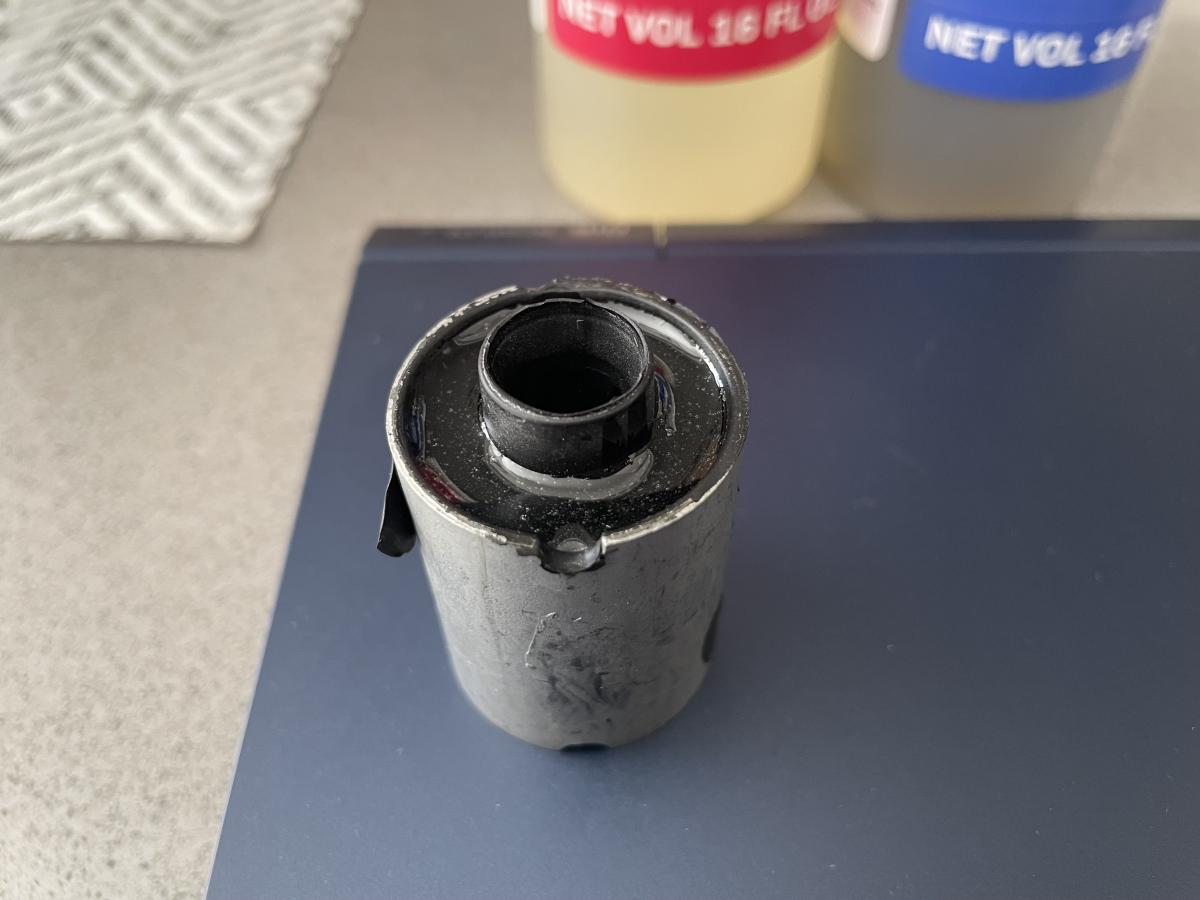

    a close up of the filled bushing

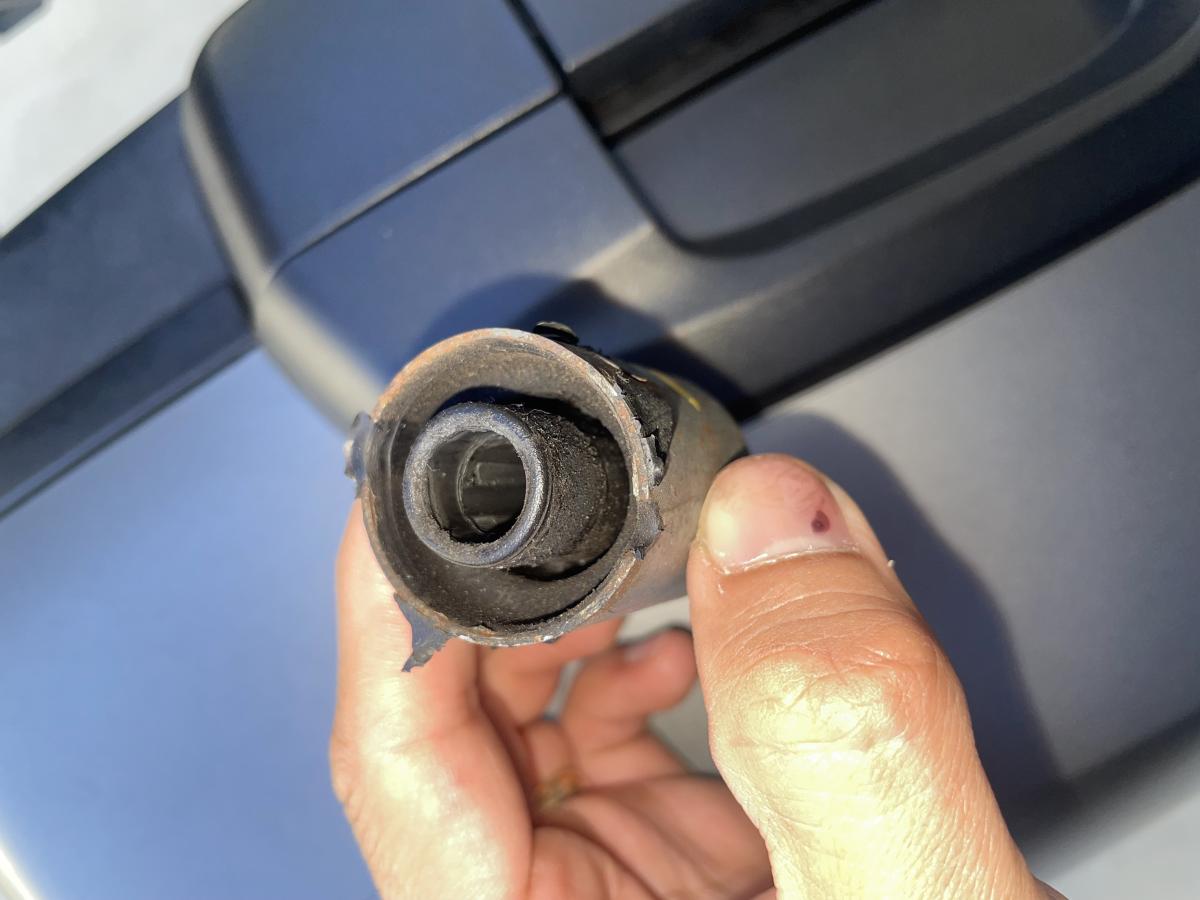

    and for reference the old bushing so you can see how much is filled

        I just installed it, I expect to be able to drive the car this weekend.
        Installation: It snapped on by hand, I was able to still squeeze the bushing a bit when comparing it to the original bushing, but obviously much less so than stock. to install i just slid in one side onto the tabs and press it up and it snapped in place.
        Static Feedback: It really did not do much for the little side to side play I have, however, it change the overall feel, the gear lever feels more solid and now there is absolutely no play up and down, the little side to side left is not coming from the bushing, but the joint to the lever arm,.also the sound changed, before it was more metallic, say it went from a clack type of sound, to more of a thump. overall there seems to be a bit more feedback to your palm.
