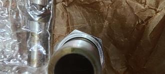

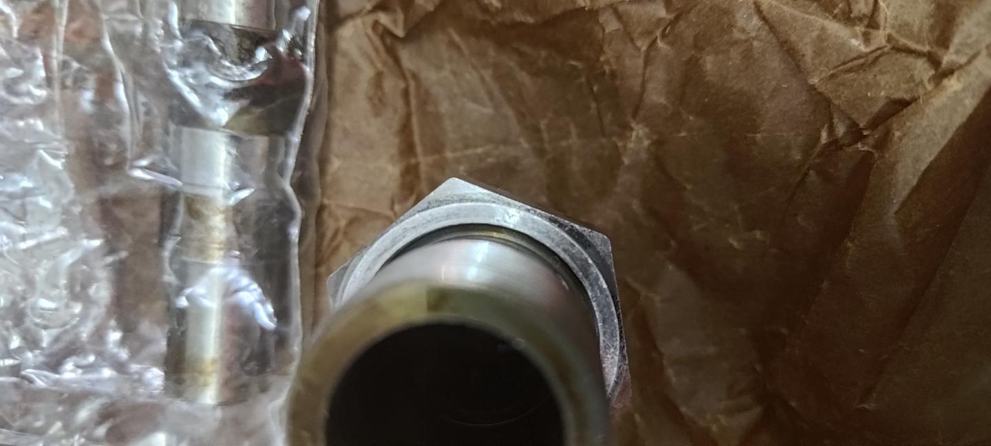

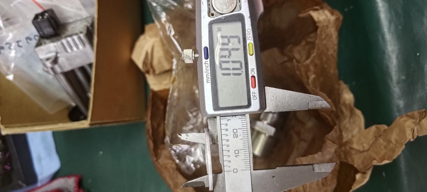

ID:	309276 Is BMW supplying the wrong seal?
    check the pics and if someone else can measure theres for me would be great

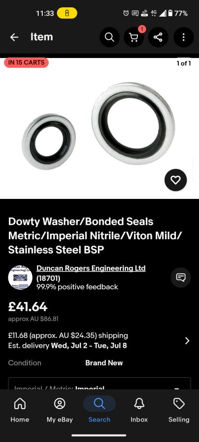

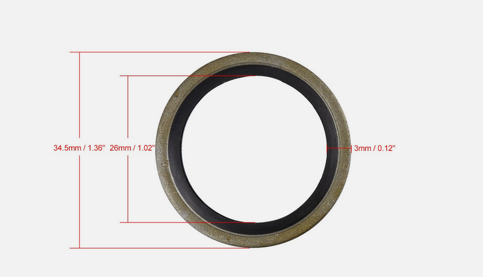

        Found a 10 pack at the moment in the high temp Viton, keep searching in Australia before i pull the trigger on that ebay item attached
          Does it have the size you need?
            The seller advised me the bonded washed OD is too big ( wont fit )

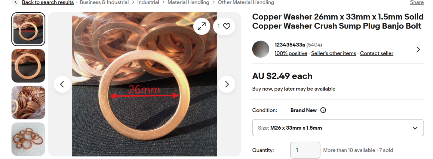

            What about a copper crush washer ?
                  Sapote, Trying to avoid sealant due to mess / clean up etc
                  Aluminum is a softer metal, so it crushes more easily, so copper may make it worse. I got mine from a BMW dealer, but you can get them from mcmaster too. they should be similar. you can try and do some annealing to make it crush more and seal.
