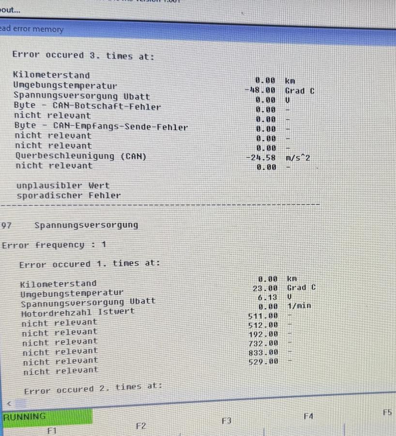

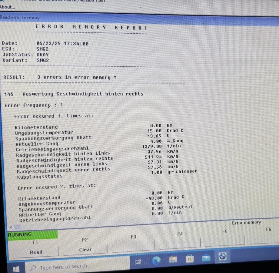

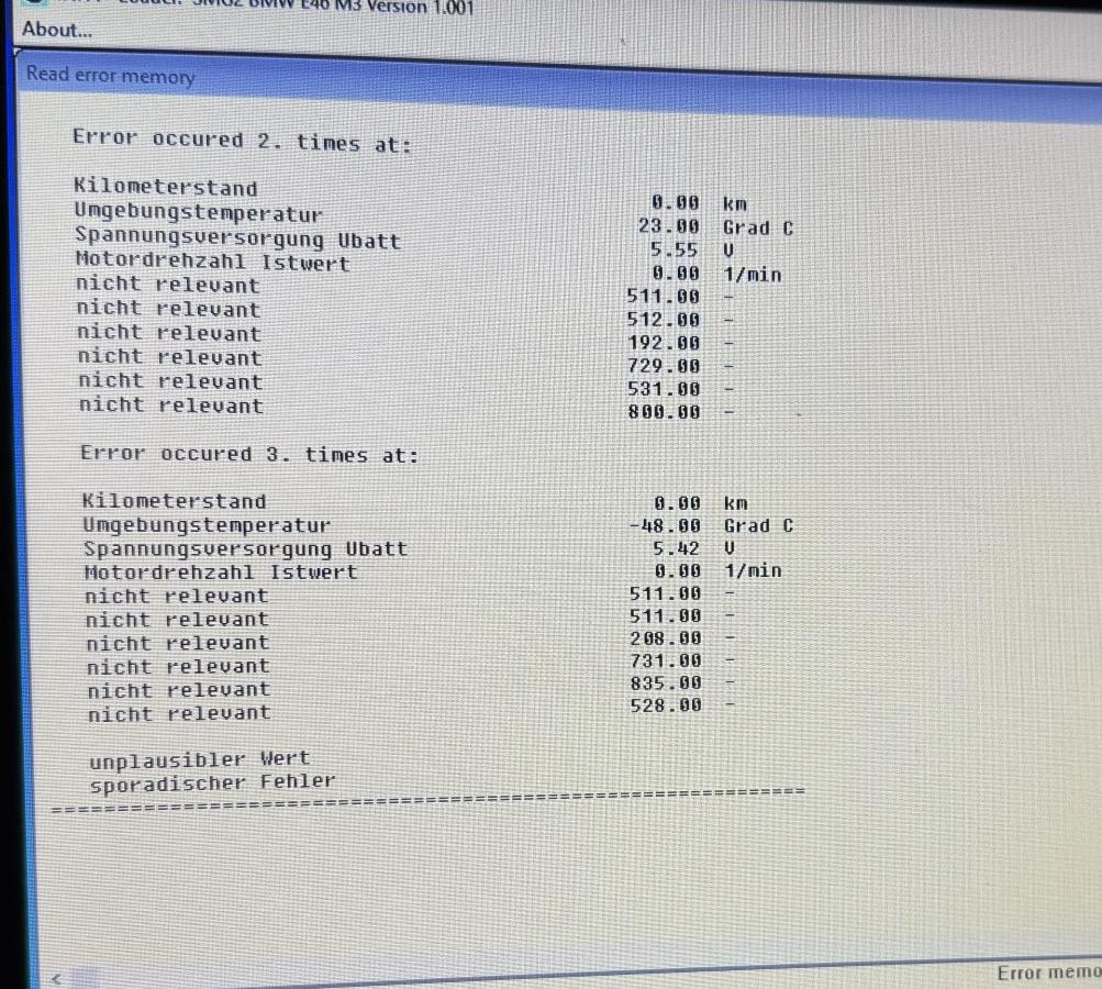

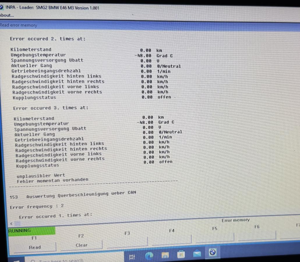

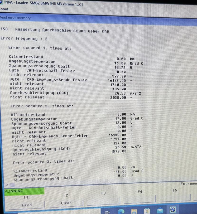

    My cog light is on and I managed to get these readings from inpa program. Can anyone tell me what needs to be fixed based off of this? Thank you

            Error 97: typically points to a voltage supply fault within the SMG system—meaning the control unit isn’t getting proper power (perhaps a salmon relay?)
            Error 146: Evaluation of the speed at the rear right wheel, Wheel‑speed sensor, fault or wiring - The SMG ECU is not getting valid speed data from the rear-right wheel-speed sensor.
            Error 153: Evaluation of lateral acceleration via CAN - This means the SMG control unit isn’t receiving—or isn’t able to interpret—lateral acceleration data over the CAN bus
            You could have some sort of grounding issue, bad salmon relay, battery issue... Those are the places I'd start. And check your right rear speed sensor, Ohm test across the pins—typically ~1.0k–1.5kΩ.
              Changed my rear right wheel speed sensor and that took care of the cog light. Thanks everyone
