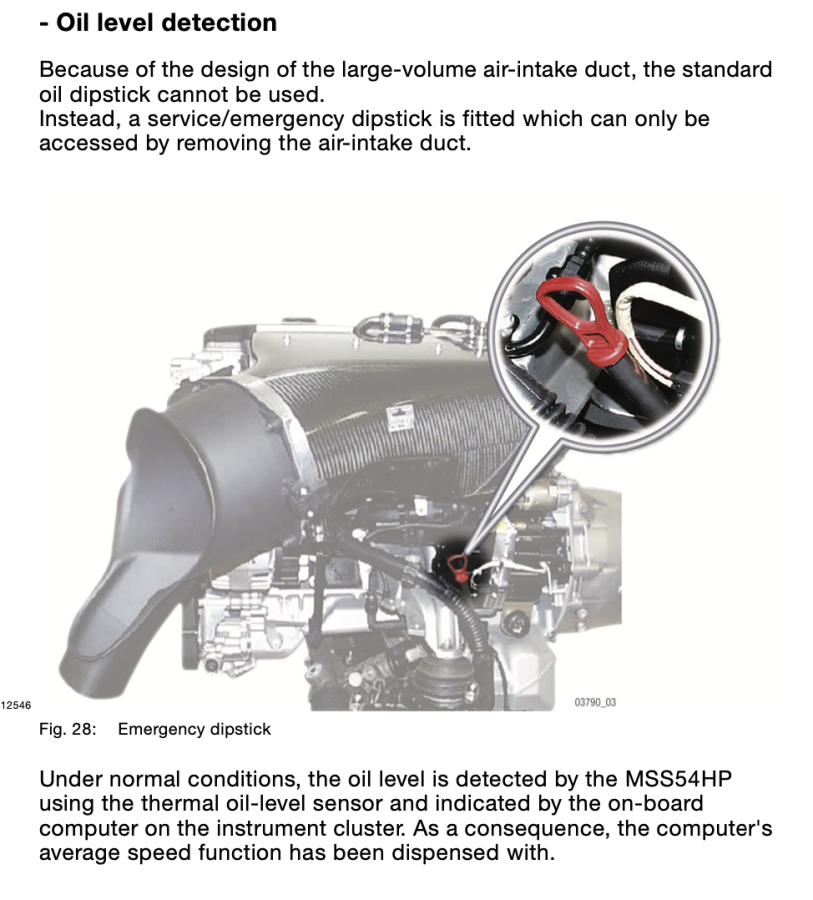

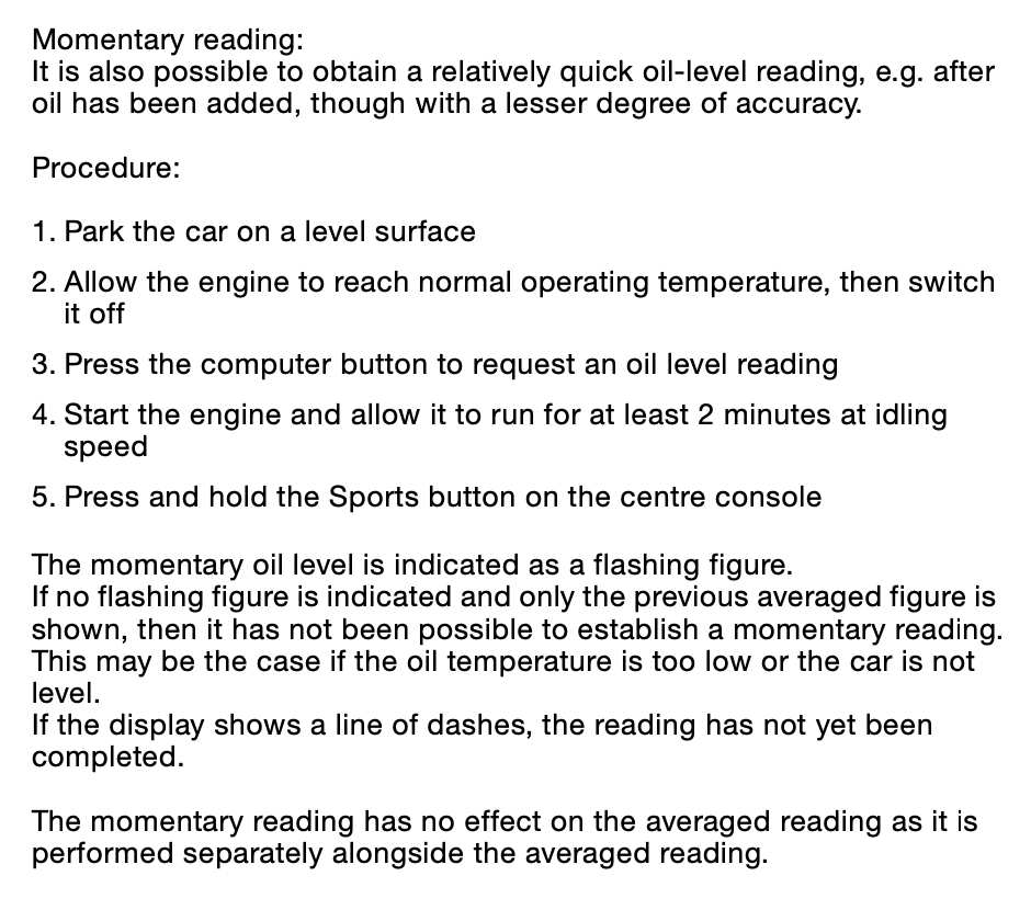

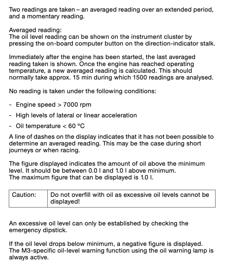

              Yeah, after the relay drops out should be fine.
ID:	309996 Click image for larger version
ID:	309997 Click image for larger version
                  Well the only thing I can think is the oil level sensor was bad. The client changed the oil level sensor most recently and drove the car a total of 70 miles before bringing it to me. I drove it 15 minutes total and then it still didn't work which lead me to the post. Thanks to Slideways for posting the BMW doc, I have not seen that before in any of my searching.
                  This last trip I got the car hot and then cruised it gently on the highway continuously for 18min, pulled over and the level was displaying. The momentary still didn't work, but I only tried it once. Now that we know it works figuring out its idiosyncrasies is easy(er).

                    So you're saying even if you start the engine and get it up to operating temperature on a flat ground and not touching the throttle for 2 minutes... Then press and hold the sport button while the BC is on oil level display... Nothing happens? It just stays with the two dashes?
                    Basically you're saying long-term oil level doesn't display and short-term oil level. Check with the sport button doesn't work either?
                      He eventually got the averaged (long-term) reading by following the procedure. It sounds like he did not make a second attempt yet to check the momentary (short-term) read. A good time to check the momentary read is after refueling at a gas station.
