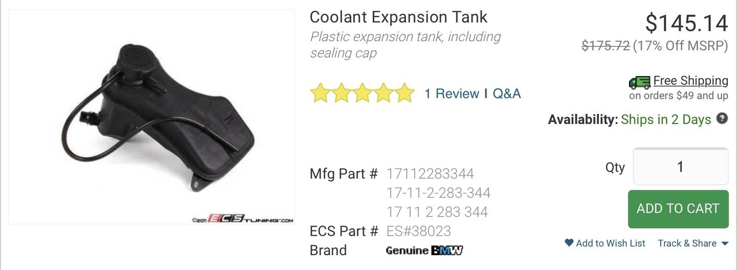

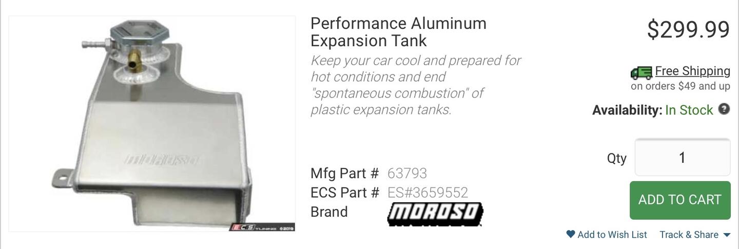

      Click image for larger version  Name:	0F303A0F-D140-4B80-9503-68B67C4A85D3.jpeg Views:	0 Size:	57.2 KB ID:	31123 Click image for larger version  Name:	7F9C48B1-A6C2-48F1-9C0F-14D4F978A454.jpeg Views:	0 Size:	54.0 KB ID:	31124 Costs a bit more...? According to ECS’s website, it costs 100% more than a new genuine BMW part. Granted, if your priority is to have a nice engine compartment, by all means get it; every fella who has 40wt coursing through their veins has bought something shiny for their sled. 😁
