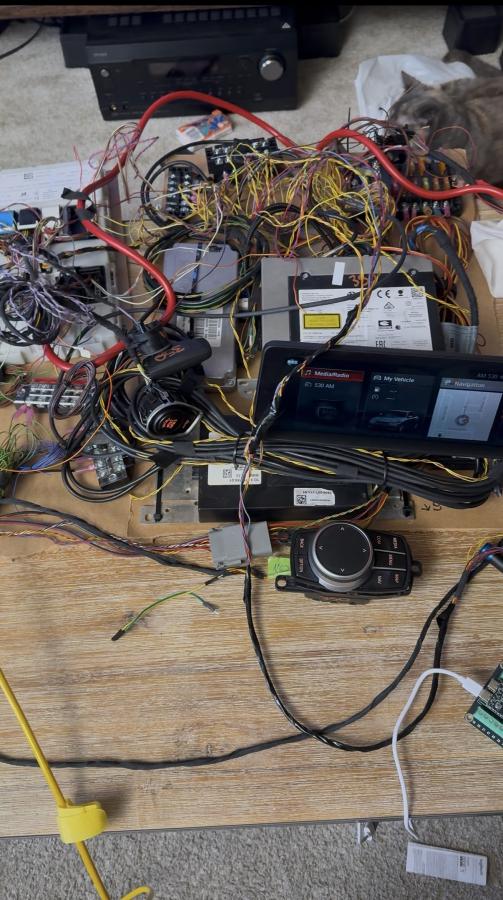

        Alright. Yes, I am in dire need of photos. But I'm in the midst of brilliance. So here's the latest update:
        - I have a sea of recorded (but not personally verified) messages
        - I have completed my F30 bench. I effecitvely can run an M240 on my coffee table, complete with iDrive controller and and working OBD port for ISTA.
        - I have custom firmware that can read and write to the bus
        - I am slowly but surely validating messages on the primary communication system for the iDrive headunit, including the VIN validation. I bought a spare headunit to try this - all my modules are tied by VIN, so I want to make sure I don't brick them.
        - I have strong leads on other messages, but I need a car to be rolling to validate them. I'm working on getting a car to assist with this.

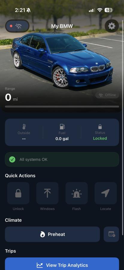

              I feel really bad I haven't posted any photos, so I'll include a few screenshots from the unedited reels I was going to put together. Here's the app:
              Click image for larger version  Name:	IMG_2869.jpg Views:	0 Size:	37.7 KB ID:	332432
              It's basically almost done. I already designed the bluetooth payloads. I forgot about the mirrors, but I'll make that a setting and a toggle. Probably just for me, but there will be a preheat option for those who aren't afraid of wiring and want to be able to preheat your driver heated seat. It can also be scheduled. You can check if your car is locked, see how much more range you have in your car, roll up your windows if you're just not sure and see where it's parked.
              I'm still debating if I want to make this a connected service so you can check things and control things from afar. I'm definitely up to it on an architectural level, but I don't know if there would be enough interest to justify the R&D. However, that would essentially make it a completely online service to track your car, get alerts about it unlocking/starting without you and check the locks and windows from afar.

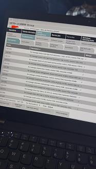

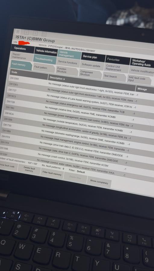

              Click image for larger version  Name:	IMG_2868.jpg Views:	0 Size:	58.1 KB ID:	332433
              Got a few codes which conveniently tell me addresses of some messages

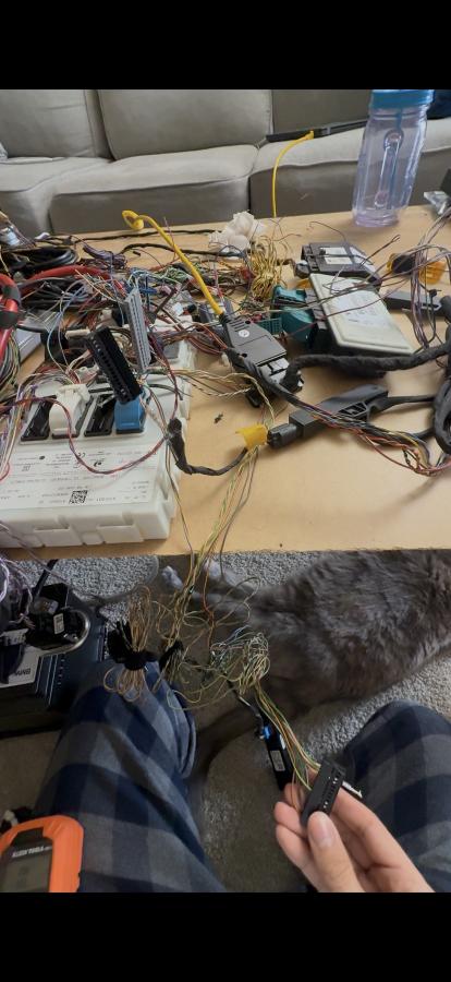

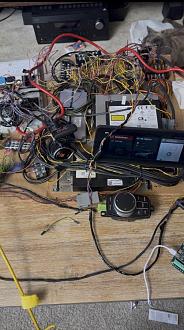

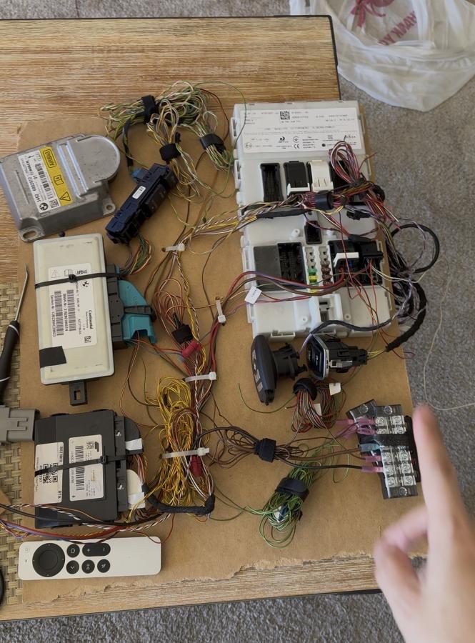

              And a few of the bench. It's broken up into two pieces: Master, slave. Master contains modules that the Fxx chassis have that I have no intention of carrying over. It has a single connection to the slave unit, which is all the modules that will go in the car. I reverse-engineered GPS cordinates, so now the cellular module/ATM is no longer something I'll bring over. Anyone who would want to follow along would only need an:
              - iDrive unit
              - TPMS (if they want temperature and a more reliable system)
              - TRSVC (if you want a back up camera. I need help creating a mounting solution for anyone willing to help)
              As Bryson knows, I originally wanted the iDrive controller. However, I have come up with a unique solution to this. I will use the RT up/down arrows and voice command buttons (programmable via the app). You can press the RT button to cycle between say: Map and Media. Or set to cycle between all the options. Hold RT to press menu. I'm still debating what the options will be. To be honest, I feel it's on me to pick 1-3 configurations that are the most relatable and leave it at that. Press vs hold programability over 4 buttons can be confusing and lead to people configuring the same options in multiple places.
