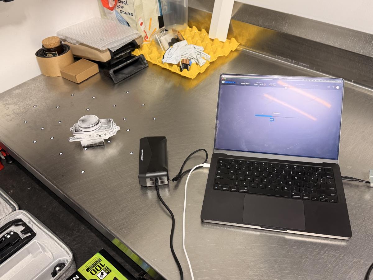

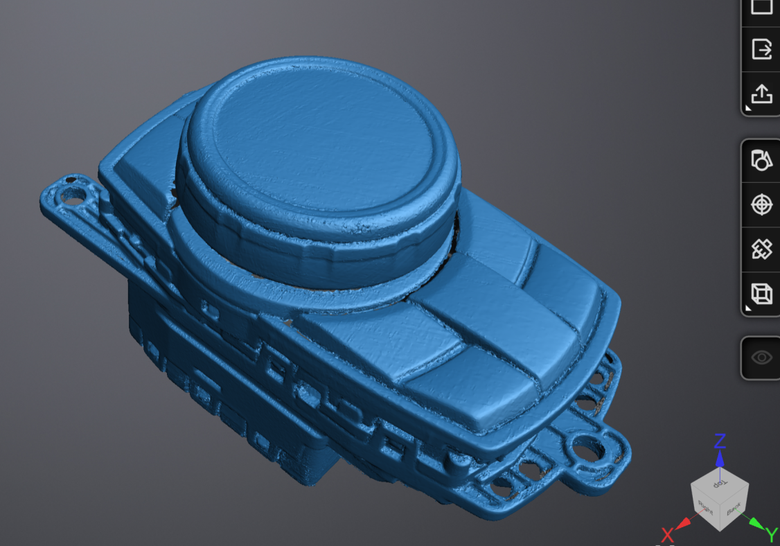

iDrive controller scan, if it's useful for anyone else: https://s.digital3dcloud.com/space/f...7-3634112ca3cd
