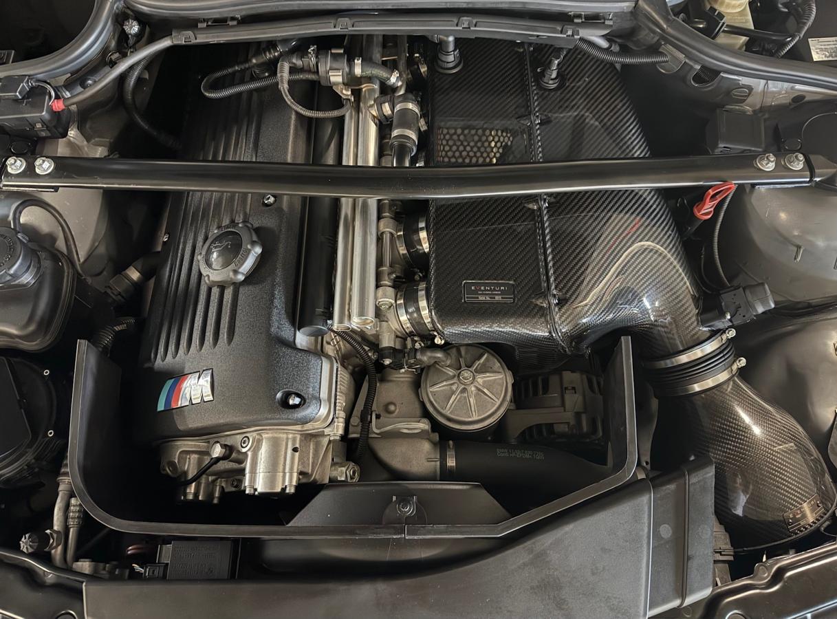

              Any issues with the strut bar?
                No issues plenty of clearance.
                  Apologies for the delay; here is a quick picture I snapped.
                  Overall, driveability is as smooth as OEM which is a huge factor for me. I had the Karb csl style airbox previously installed and ultimately had to swap it back out because I never dialed it in right for city / low RPM driving.
                  From a sound perspective, the note is fuller than the intake alone. I would analogize it as 1) eventuri intake - trumpet; 2) hybrid airbox trombone; 3) karbonius csl style airbox tuba.
                  The Karb definitely has more bass resonance at lower rpm 3-4k / and wails equally as loud at 6-8k rpm with slightly lower tone. However, it always felt and sounded a bit gimmicky to me since I didn’t have the rest of the exhaust done.
                  The hybrid does a good job of giving a bit more fullness due to the carbon resonance while still feeling very OEM+. My guess is the Karb OEM box sounds similar. This package aesthetically looks more uniform and complete.
                  Happy driving!
                    The Karb is definitely has more bass resonance at lower rpm 3-4k / and wails equally as loud at 6-8k rpm with slightly lower tone. However, it always felt and sounded a bit gimmicky to me since I didn’t have the rest of the exhaust done.
                    Happy driving!

                            Those that have installed, what are you doing about the dipstick?
                            2006 E46 M3 Interlagos Blue ZCP Slicktop "CS"
                              Originally posted by akamin68 View Post
                              Care to share the part# for the lower hose you replaced. I'll pull one in before my install just in case
                              Yea could be worth doing as mine was dry rotted and brittle. I also did the throttle actuator that’s under the airbox and the CPV hoses same time while I was in there.
                              BMW Crankcase Breather Hose - Genuine BMW 11617831336
                                The airbox has a nice bracket that clamps it and holds snug with pressure around the dipstick and a foam cushion so it does’t slap around.
