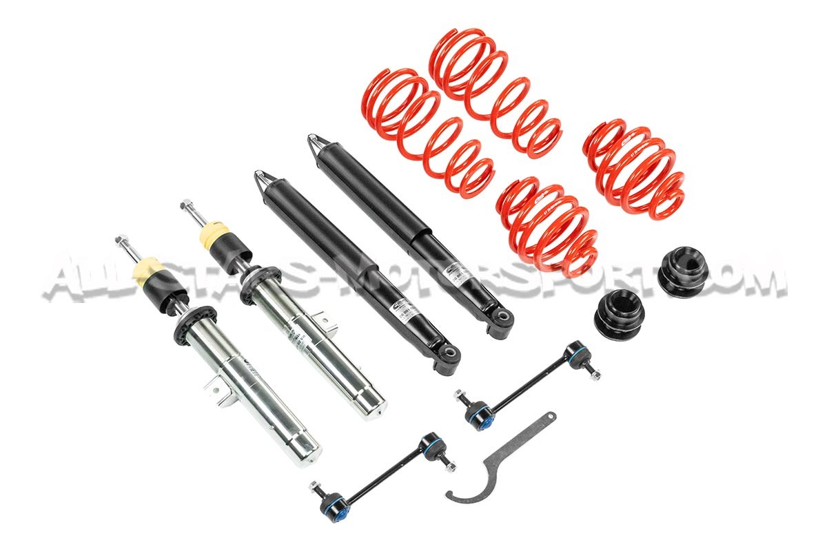

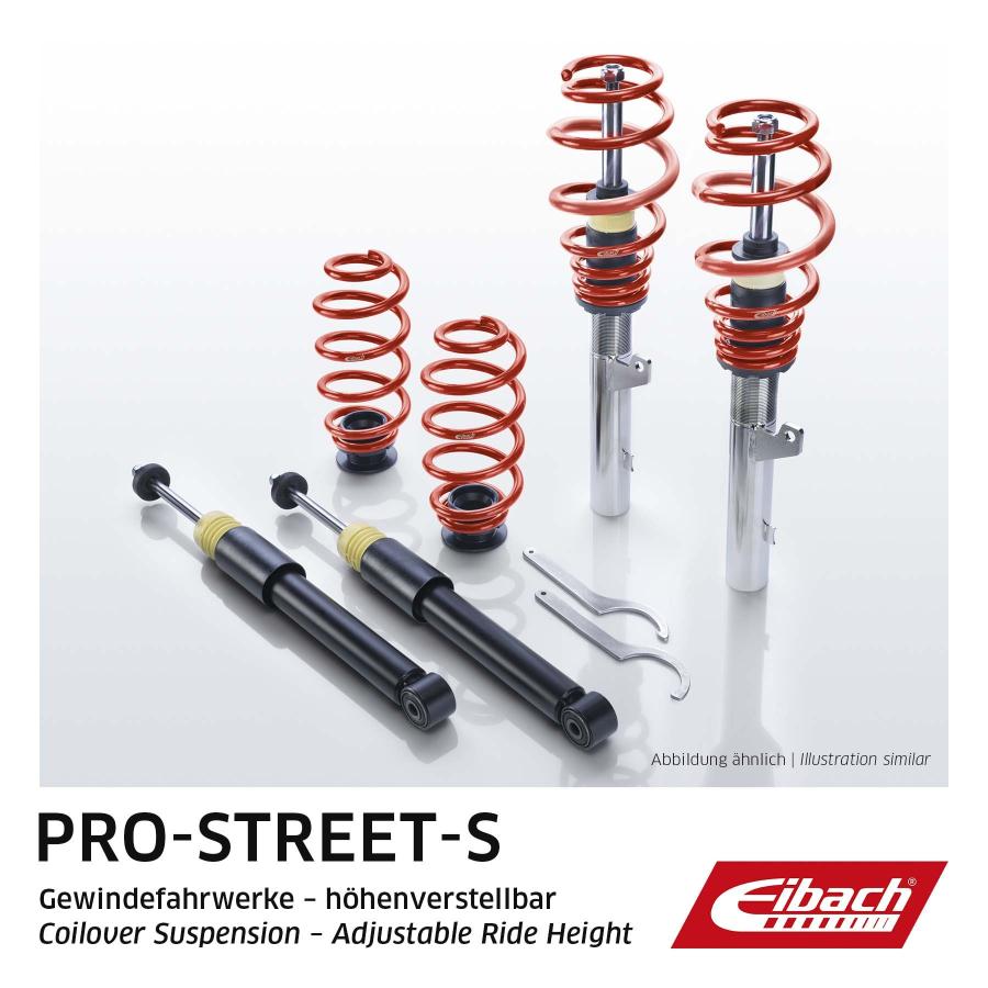

                Also, what is the name of that suspension ? I bought it from someone at Eibach 8 years ago, and can't really find any information online about it. The Pro Street S is another system from them, but labeled the same ?

                      In France, the pro street S doesn't have linear springs etc...
                      It's this kit :
                      2004 E46 M3 • TiAG / LSB nappa
                        Originally posted by Flow View Post
                        Yep
                        Interesting concerning the suspension.
                        It's this kit :
                        https://www.all-stars-motorsport.com...278042369.html
                        Did you buy them from EIBACH USA or EIBACH Germany/Europe?
                          I bought it directly from Eibach in the USA, from the guy who actually made that suspension, but I can't find the emails anymore, and m3forum is gone with all the PMs I exchanged

                            Yup i know who you are talking about, I actually think the US and Euro versions were different. I remember lookin in my dealer portal on Eibach Germany and seeing different springs unless they used a generic pic which they usually never do. I have attached the Picture from the portal from Eibach Germany.
                            I would install the US Versions since that person went through some good work to test them and develop them. Also I cannot see the Pro Street S on the EIBACH USA website anymore:

                              Yes that kit seems to be a legend haha.
                              It makes me think of our local craigslist, where everyone thinks he has a rare item and asking a premium for it.
                              I'll be running that suspension as when I bought it, it made quite a good consensus.
